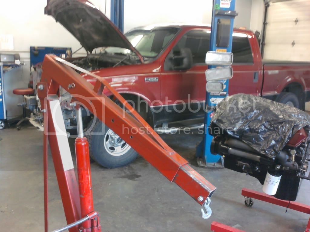

The turbo delete was made so I could run the engine with the turbo's off for the hot retorque. Those turbo's are a pain to pull when they are hot.
907DAVE
May 21, 2011
2,166
AK
Last time I pulled the cab to do the hot re-torque....but this seems much easier.

I wonder if i would need to do a hot re-torque??? ARP says I dont..
Hot re-torque is a must with FireRings.

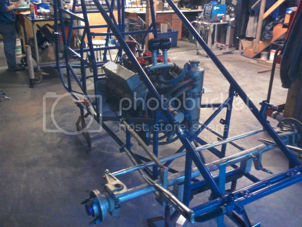

It really kills me that this thing is still not running yet. Just got home from a buddy's shop, the Legends racecar is back together after a rough night of racing, and the sprint car build has just begun. Once the sprint is done there will be absolutely no time left for anything else, going to really push to have this thing done next weekend.
Teaser......
FORD7.3
450
thats bad ass!! is that what you guys do for fun up there in AK?
907DAVE
May 21, 2011
2,166
AK
Alot of motorsport related activities up here, racing is just a summer sport for a bunch of us.

Got started on it this morning, and I just finished the hot re-torque. Had to sit down after that.....pheww.
I have racing tonight so it will have to finish up tomorrow.
907DAVE
May 21, 2011
2,166
AK
Truck is all back together and driving again, I have a few issues to sort out and it will be DONE!
I will get a video up within the next few days.
