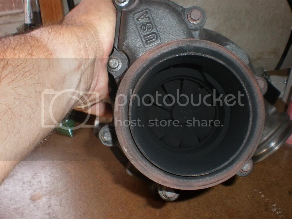

first step of elimination
both the inlet and outlet of the turbo looked nice and sealed to me
no tell tale soot marks outside the sealing surface.
now the wastegate. tell me if this is the correct actuation

your turbo is fine dude! you prolly had a boost leak in the compressor side of the system... not a exhaust leak....
