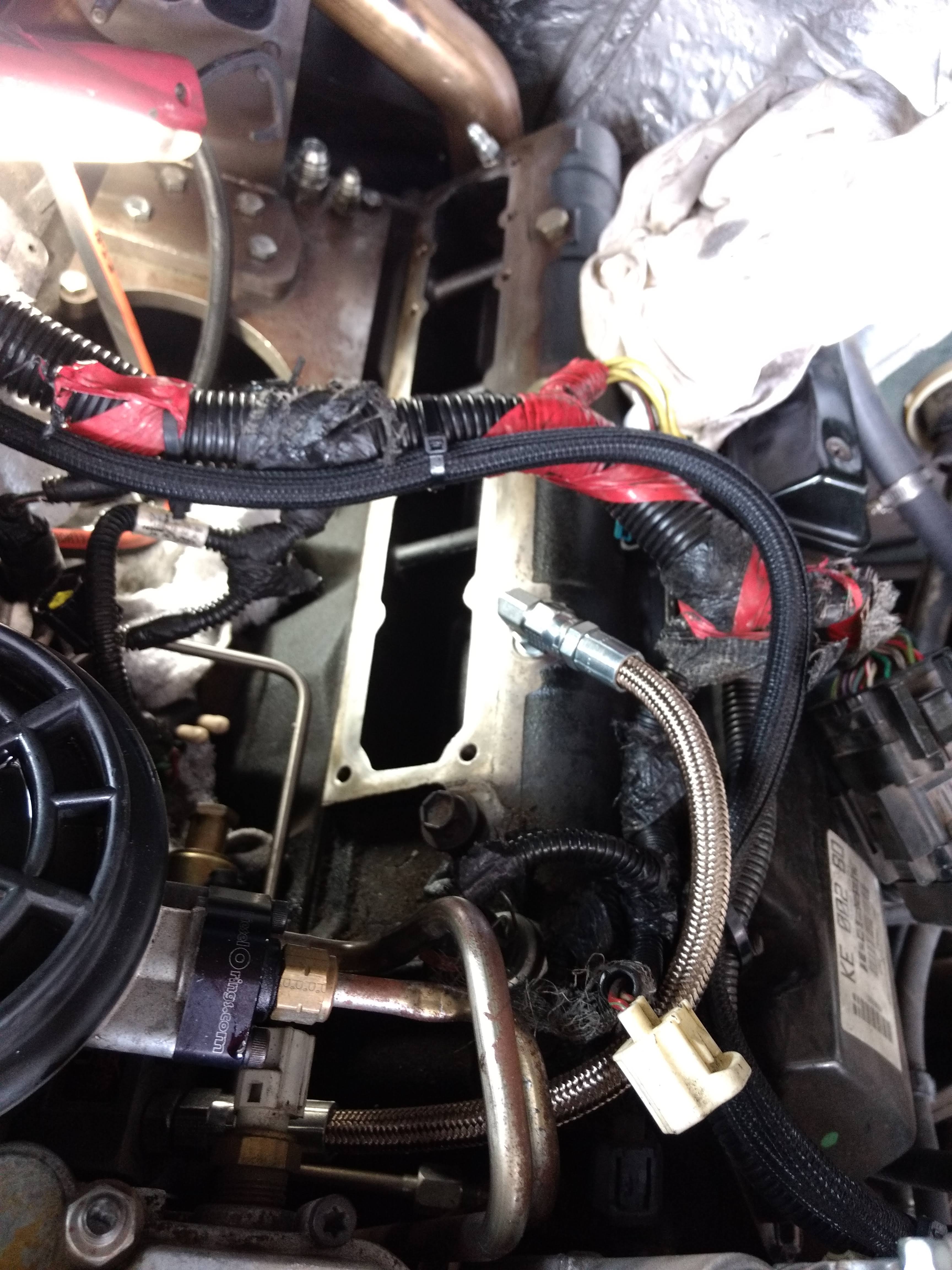

Got it all buttoned up today. Decided to take the "hard" road and remove the RiffRaff billet plenum and break the seals on the T500 pump to install the new version CNC Fabrication HPOP lines. They seem to be significant improvement over the first gen. Truck is ready to start, checked for diesel leaks having used heat sleeving on the rear feed lines which required taking them out. Just have to let the loctite 680 cure for 24 and then it's crappy starting time with all the air in the HPOP system.

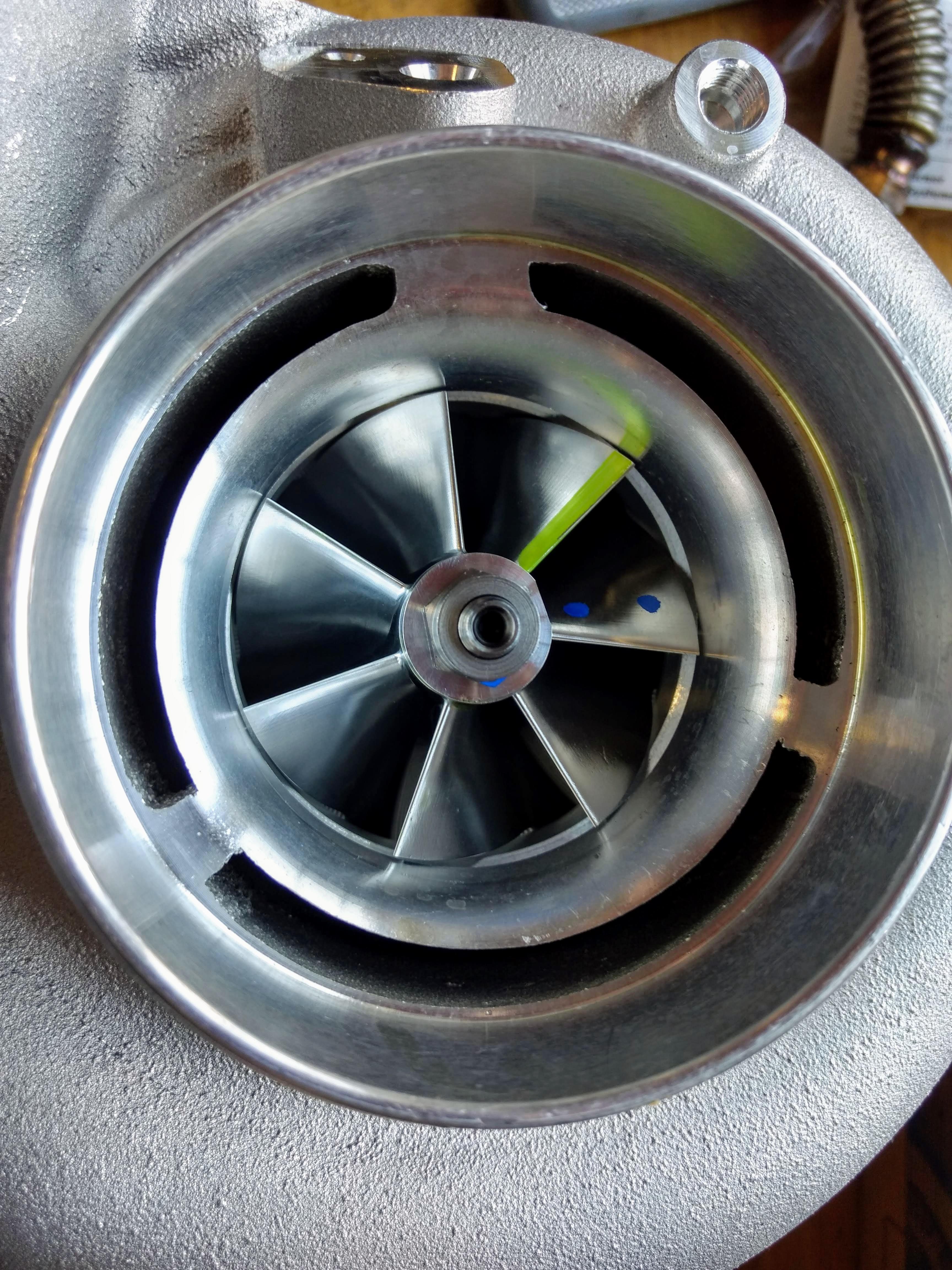

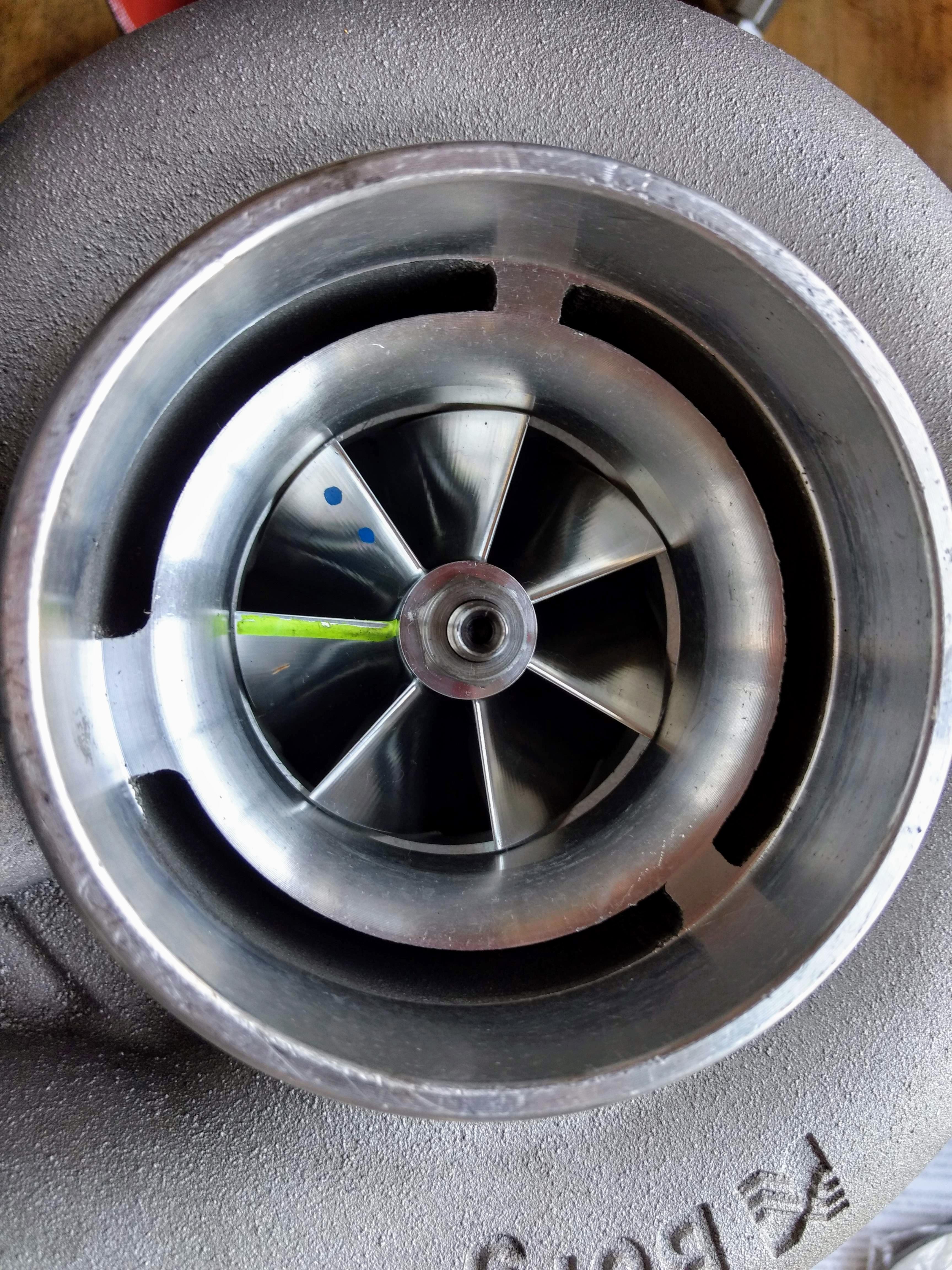

364.5:
366:

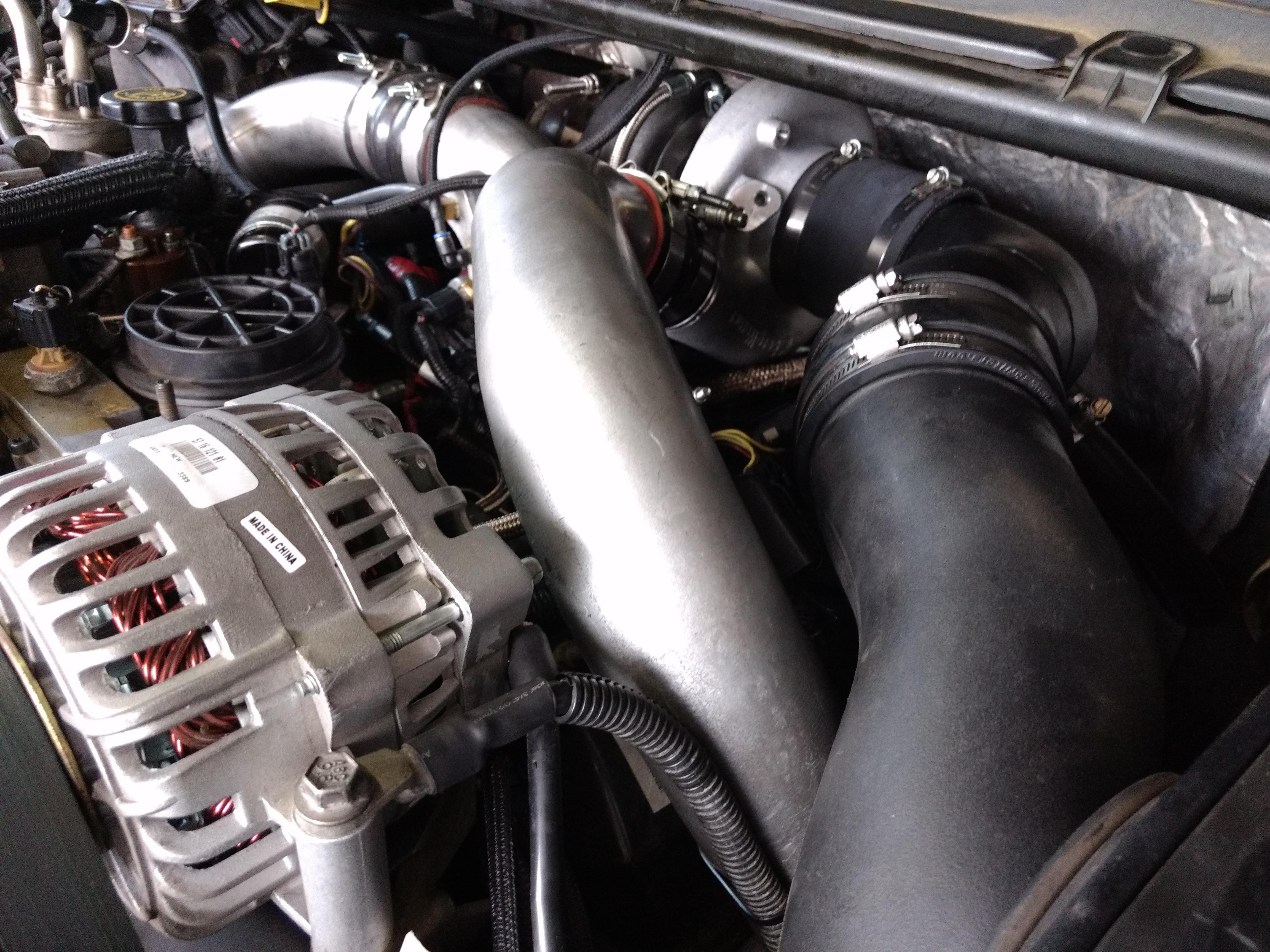

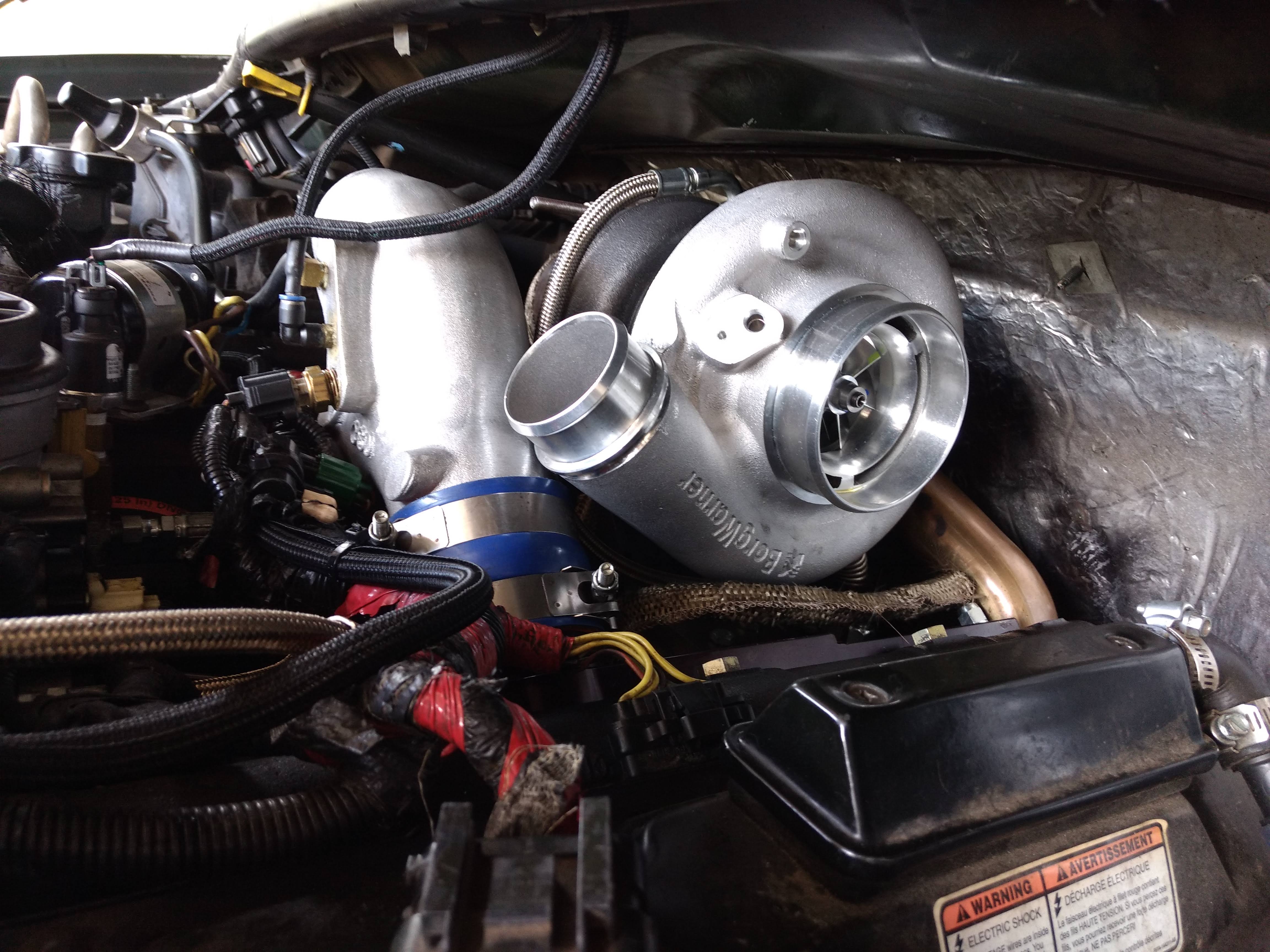

Completed everything and she started up better than I expected with no issues.* I've only driven the truck to work one time and my wife drove it around like usual today.* From her perspective, she sees no difference.* Now, what she doesn't know is that I determined pretty quickly on my drive to work that with the 1023 economy tune, the 366SXE isn't very happy.* It was more smokey and little more laggy at light to moderate throttle.* So, I changed to the street shredder tune and now the turbo runs great.* There is more "timing" with this tune as the throttle input is a bit snappier than the economy tune, but with the 364, street shredder was a pretty smokey tune.* Not so with the 366.* Slight hazing at moderate throttle until the boost hits 20 which is very quick and then it's game on.* I didn't have clear road to try anymore than about 1/2 throttle as the truck is really quite fast.* She did not know I changed the tune, but I think that speaks to everything working fine.* *There is no difference in turbo sound, but I think the exhaust has changed a little louder/deeper with the 1.0 housing.* We're looking for a mountain lake to camp next month so towing will come pretty soon as will some more time behind the wheel on my part for a better read on the difference.* So far, it seems like a positive move though.
