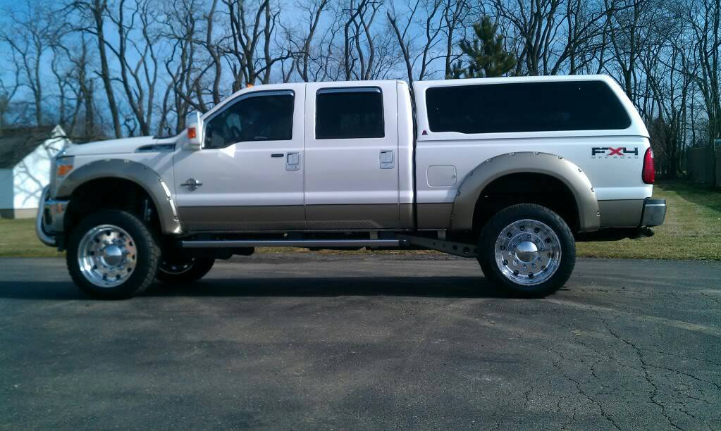

I'm looking to get the clearance for the 22" 10 lug "super singles" with adapters and 35" tires. Similar to these trucks.
