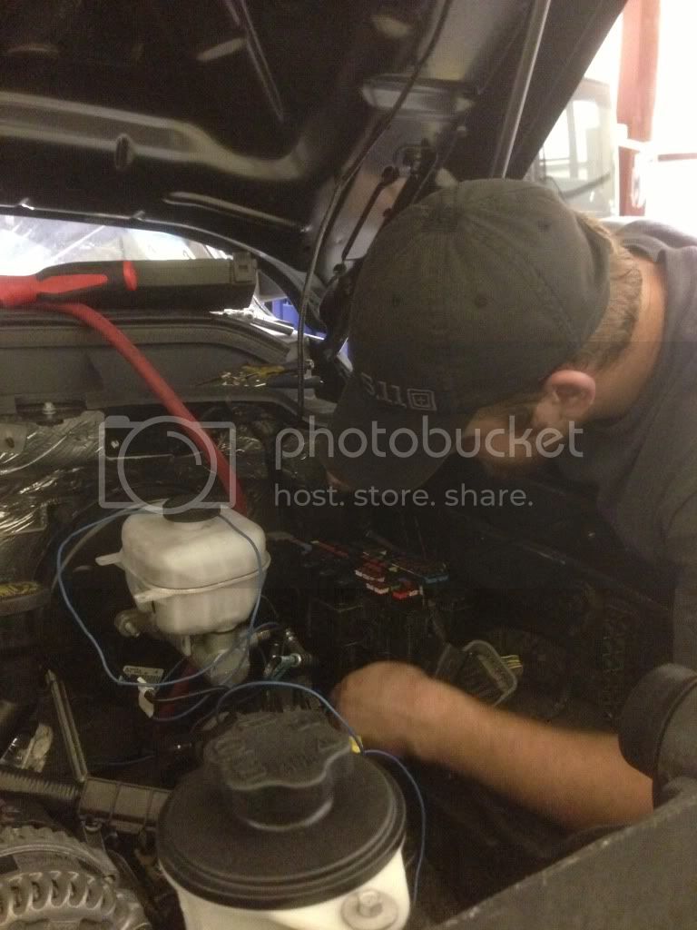

Getting started on mockup. Big thanks to elite for getting them out.

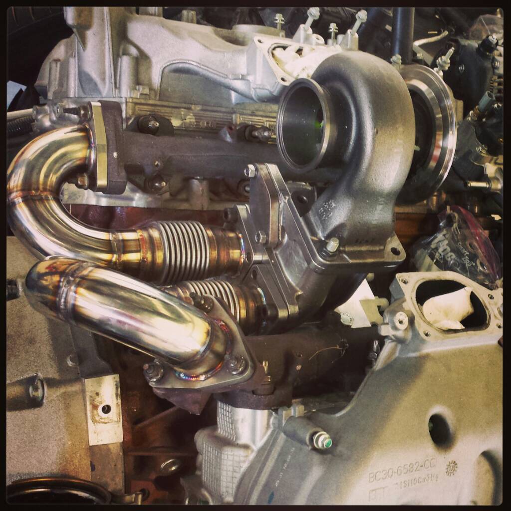

Hard at work tonight making sure the twin factory LPFPs operate just like they should from the ford plant.
