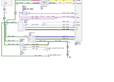

Sounds like a cool idea, I am able to get you the Ford wiring diagrams for the 6.4 VGT actuator - but I'm not sure about the schematics for the electronics inside...

Here's the wiring...

According to that wiring diagram, the VGT on a 6.4 is controlled by a signal from the PCM. The PCM duty cycles the actuator by a command sent over the CAN network, which is then interpreted by the actuator and turned into physical movement.
How are you going to accomplish that without a PCM that has specific software for a mechanical VGT actuator? I know that 6.0 VGT is oil pressure controlled, could you take the signal for the VGT oil control valve and translate it to what you need? Maybe... but that is a hard wired component. The 6.4 actuator is decoding a signal sent over a high speed data bus...
Anybody have any thoughts?

Kris,
Thanks for the image, however it is too small to see anything... What I need to figure out for the VGT is the voltage/ohms or whatever it is that changes to tell the actuator what to do. Or maybe at least which pin on the VGT connectors do which function, and I can read the outputs from both engines... That could work.

The problem you will have is with the VGT. The actuator doesn't get voltage and ohm changes to make it operate. It gets a command over the network and internally converts the network command to an output.
To make it work you need to send it a command over the network. There are only 4 wires according to the diagram. Power, ground, and BUS+/BUS-. The data bus carries the command to the actuator frm the PCM. Without being able to copy that command, it won't work.
How are you goingto do that without a 6.4 PCM?
