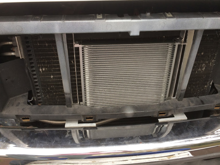

Just did some measuring of the BPD cooler, looks like 24 x 7.5 x 1.5" (bar and plate) totaling 270 CI. Not questioning MPD's sizing of the cooler, just trying to figure out what I really need. My business partner has the BPD kit on his truck and tows 7K lbs daily, with no problems.

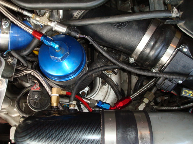

Started installing the oil cooler/filter relocation plate from MPD. I hadn't thought much about the original oil filter housing being deleted, this means my fuel bowl will be suspended by the fuel lines. Anyone have thoughts? Hope to get it all put back together tomorrow night.

Id delete the factory bowl and open the whole valley up it will look much cleaner imo.

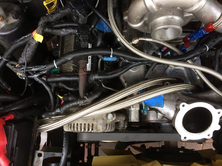

Well I said :wtf: and cut it off anyway, can keep sitting on it. Oil cooler is mostly all in, just need to tighten everything up, put in the CAC pipes tighten up miscellaneous items, top off fluids. Then we will see if it continues to stall out.

You bet Morgan! Not taking any chances... I am glad I decided to do the oil cooler gig, turns out all the bolts on the factory cooler housing were never tightened. I was able to remove them all with just a socket on an extension with my bare, oil soaked, hands. Really disappointing with all this BS.
Looks good!!
Thanks! Dont forget you will need some new fittings to adapt/re-feed your turbo's with oil for your setup.

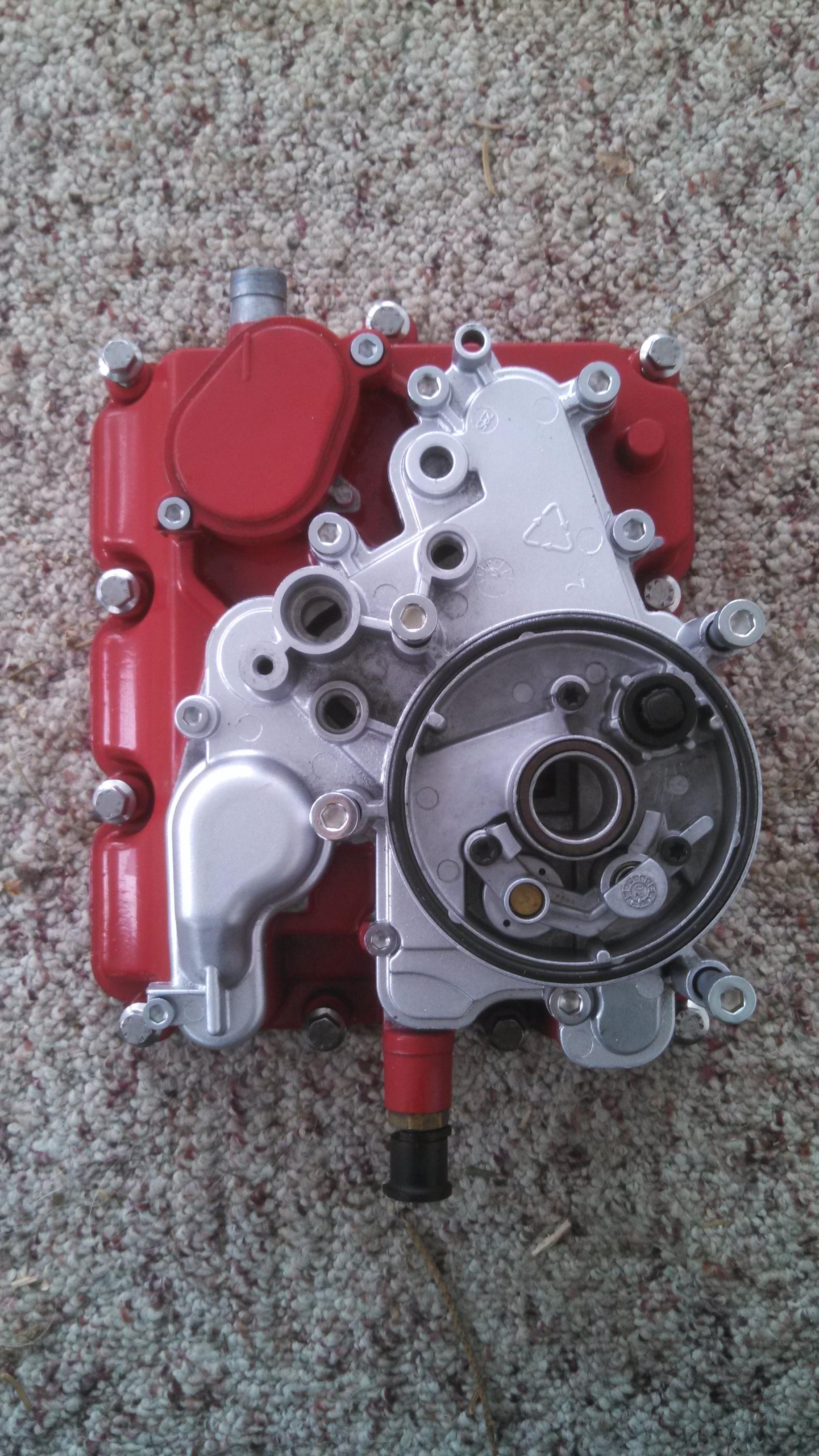

Here's what I'm doing with my factory oil cooler covers. Painted and all new bolts. Bottom cover has polished stainless ARP bolts and the top cover has chrome plated bolts. I'd love to do the MPD setup you just did but I want to do so much this spring and money is gonna be really tight. Not sure if I'll even be able to do all that I wanna
Yup, I brazed a -6 jic male onto the factory feed line should work good.
