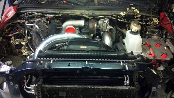

Since our customer, Dave isn't a member here I thought I'd share a few progress pics of his project I've been working on for the last little while. I'm not trying to sell anything here, but if any of you are curious on how things have been done/fit so far I'd be happy to answer a few questions.
The truck is an '05 harley edition CCSB that showed up with a decent running, studded 6.0 he wanted to do compounds on. After going back and forth, figuring out how we would have the most reliable 800 HP he can tow heavy with at any altitude, we decided to convert to a built 6.4.
I still have the mock-up engine in, but with any luck we should have this truck running some time within the next month or so. Believe it or not, most of the complicated stuff is all figured out, so it's mostly a matter of dropping in the new engine, and hooking stuff up. I should have a couple more pics I can share in a bit that show things at a few different angles.
If all goes according to plan, we should have functioning climate control, cruise control, and all the original factory gauges working with no CEL.

Pretty cool swap. How'd the firewall clear?
Excellent. the engine is in the exact same location as the 6.0 was. The only thing that might need some massaging is at the base of the L up pipe depending on if he goes with steed speeds. He's planning on them pending dyno results of the newest version, but if they don't do awesome right off, then the ported & ceramic coated 6.0 manifolds with the conversion up pipes should fit, but tight like they did on the original engine.
We will have to run turbo blankets too, to keep the heat away from the 6.4 pcm though, as it's a little too close for comfort otherwise.

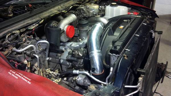

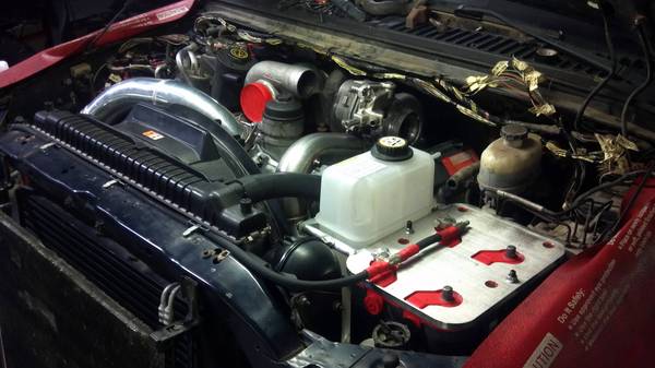

Here's a couple more pics at the same progress point from different angles.
