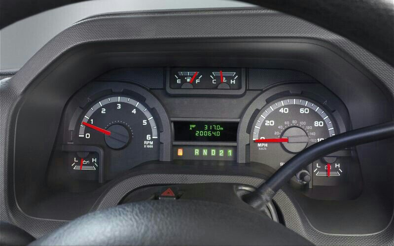

A/Ox4
Jul 2, 2014
40
Let me throw a wrench in it. If you can get the 6.0 cluster to work, get one from an 08-10 E-Series. They got the updated interior, and a newer gauge cluster to match, but still had the 6.0. The gauge cluster is in the style of a 6.4 cluster, but dumbed down. I like this cluster a lot more, and if you have the balls to do a dash swap it looks sweet.
