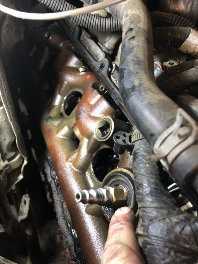

I put the air adapter in the front of right cover and applied air to cold engine. I just get air coming out of oil fill tube.
nsfr1206
May 26, 2017
32
So I should take covers off and dig deeper I suppose. Also, where I screwed in fitting had oil in it. Is this normal?

If you put it where I think you did, that's the icp sensor, so yes, should have oil.
I would pull the cover.

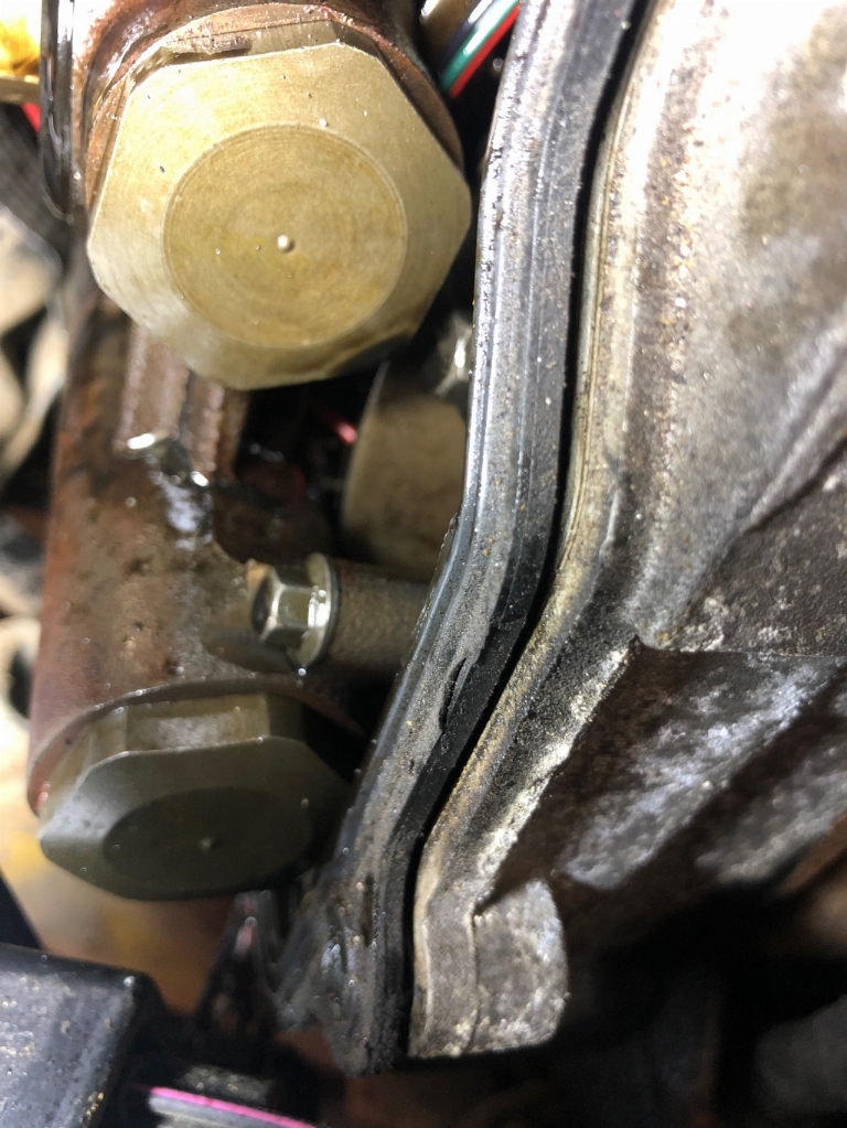

It’s leaking here even though it has an oring on it to seal.
nsfr1206
May 26, 2017
32
It’s actually leaking from under the fuel rail by the injector.
Should it be leaking here?
