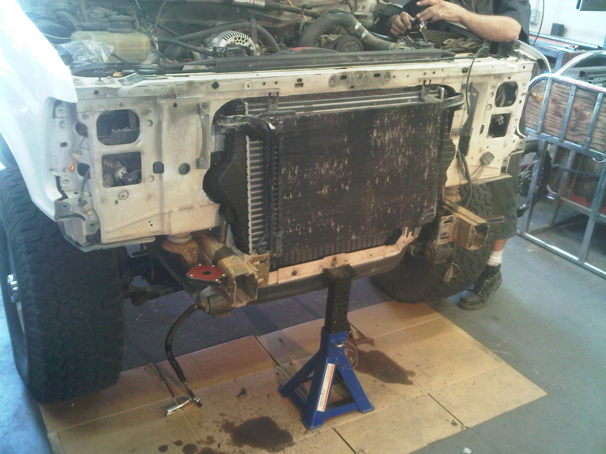

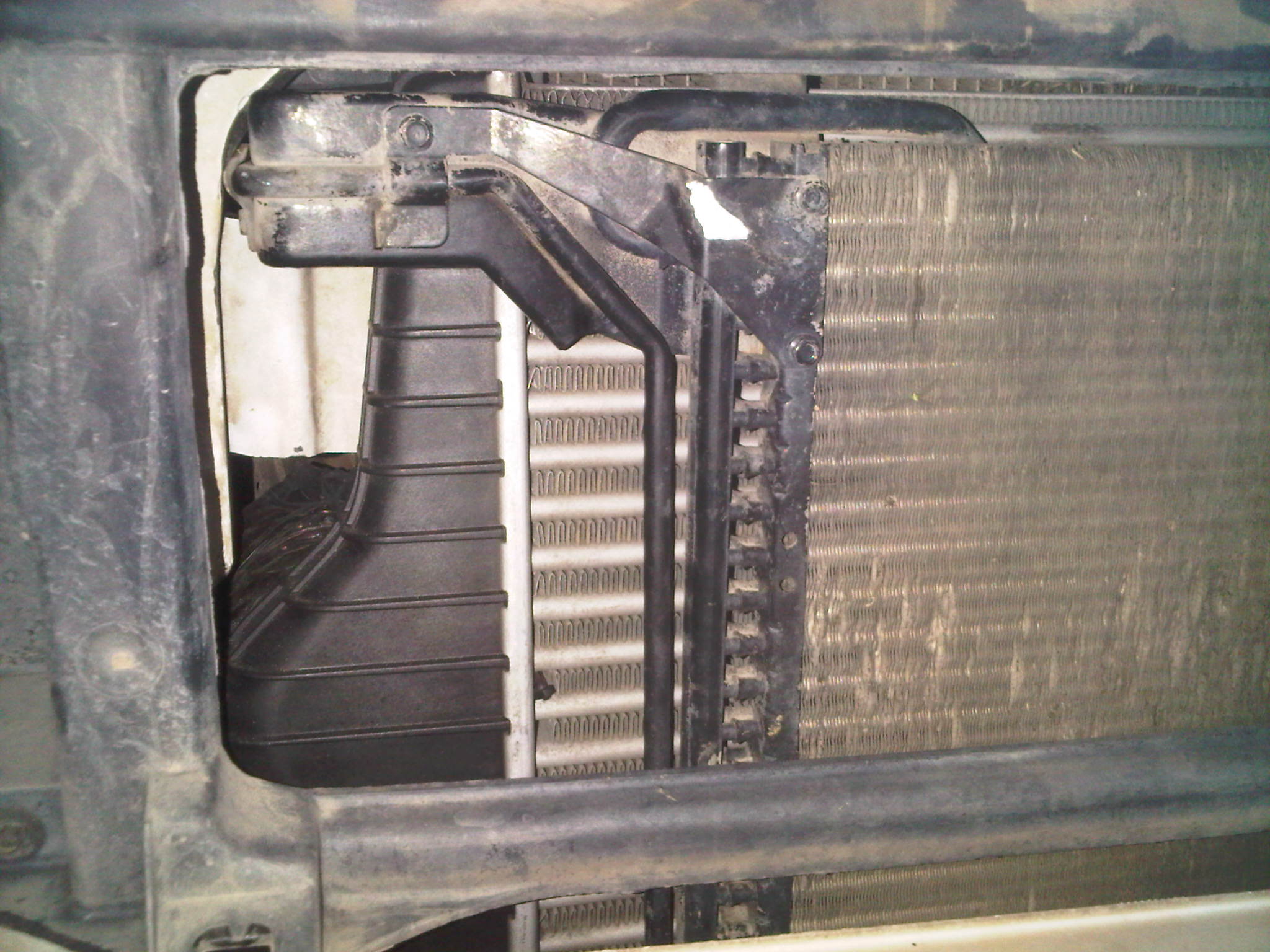

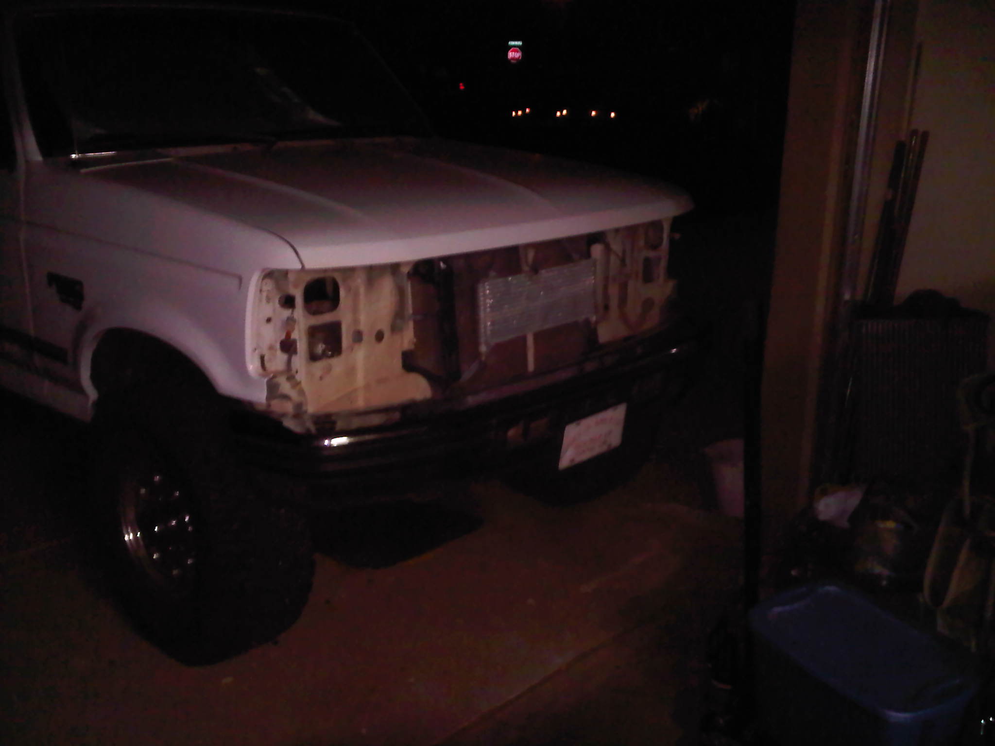

Newman wanted me to post up these photos so here you go. Looks interesting for better AC perfomance in really hot areas.

Thanks Tom! I plan on doing another install in a few months and I'll try and get better pics. A longer high pressure side AC line is required. The low pressure side can be straightened out a little and is long enough

The top mounts on the CAC mount on the rear side of the core support. The e-bay tubes will no longer work due to being to long
