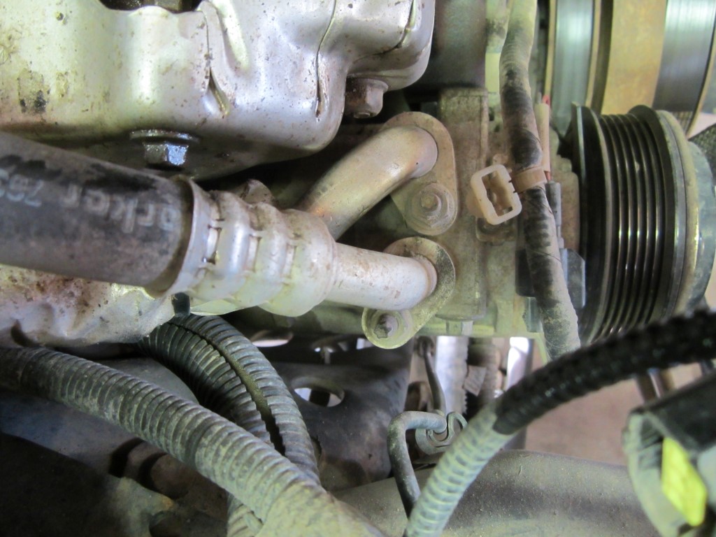

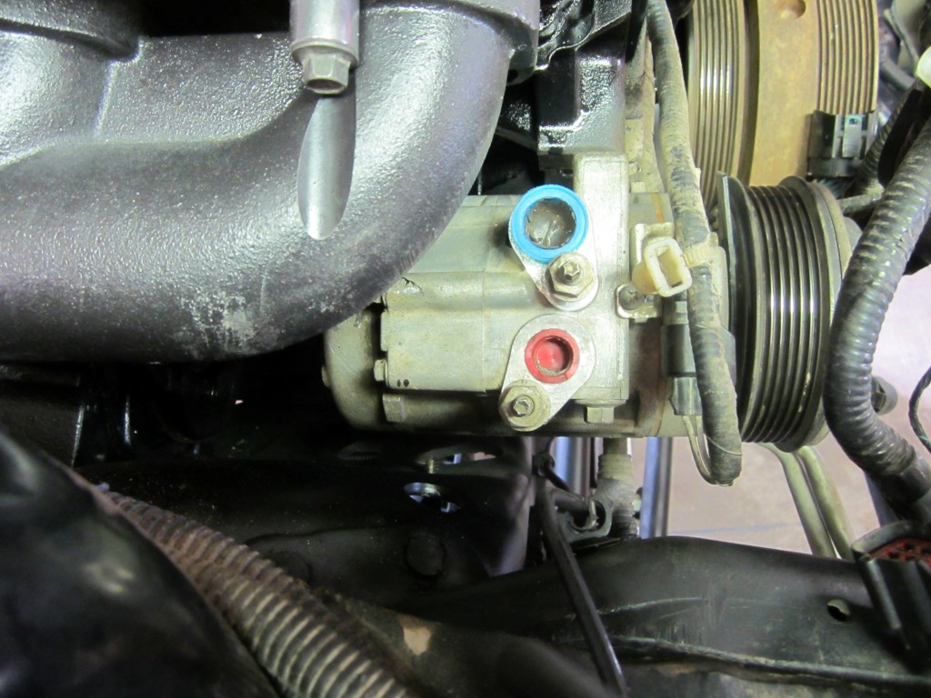

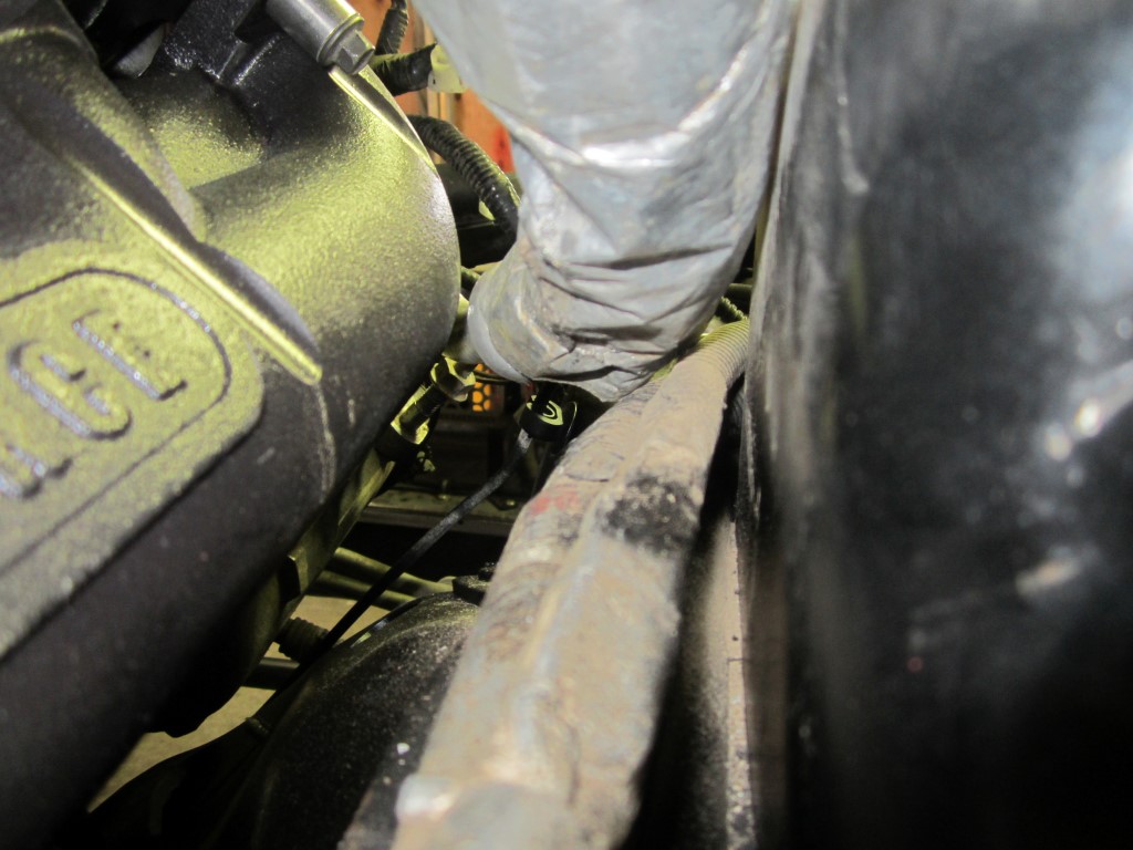

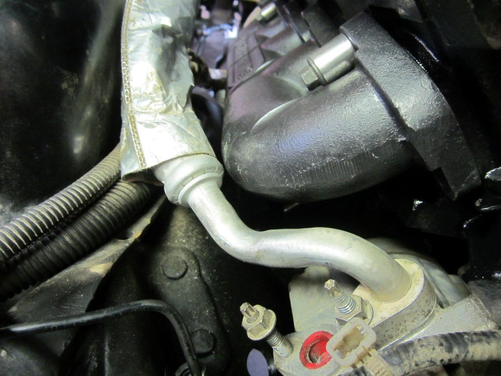

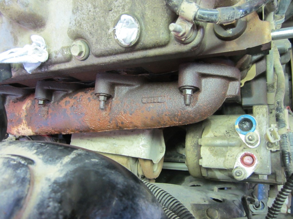

In the process of putting the 6.0 ltr manifolds on the engine & the low pressure AC line clearance on the RH manifold isn't worth crap. A little massaging & tweaking of the line got it so it will clear, but its just not a great fit. Anyone using a different line, or making one?. Or is bend and tweak the norm? I'm going to wrap the section of hard line with heat wrap & then slide the factory shielding back down so it will probably be fine, I just don't like the overall fit between the two.

That's probably more room than what mine have. It's a normal thing when putting those manifolds on though.
08BIGRIG
Nov 26, 2011
1,814
WI
Bending the lines out of the way is the norm for those on the 6.4's I wouldn't worry about it as mine is closer than yours and I have no issues what so ever.

Mines close too but I just put the original heat shield in between the manifold and the line. I haven't had any issues with it yet.

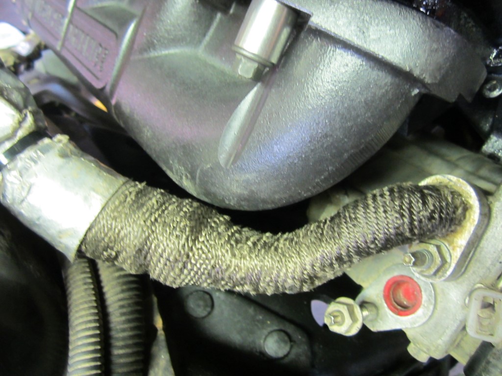

I try to warn everybody about the 6.0 manifolds for the 6.4 bt whatever.
Look into HeatShield products and use the 1/2" stuff and it will work great.
Pm me and we can talk.
I use it from turbos down past the DPF delete pipe to keep heat where it needs to be and heat away from things that don't need heat.
I crack up at the 6.4 guys saying they don't need HeatShield due to cost with the 6.0 manifolds and then 6 months later they are all upset because their a/c lines are all burnt up.

My RCD 6.0 style stainless logs were like that to. Bent the AC line and move on to other problems.

I've never ever heard of there being problems. Anyone with any common sense will just bend the AC line so it isn't touching the manifold and its fine.
If the factory 6.4 exhaust system reaches 1500 degree underneath the cab and doesnt have a heatshield I'm pretty sure that heat shield isn't needed on an aftermarket delete system that reaches nowhere near those temps. But hey it's your money

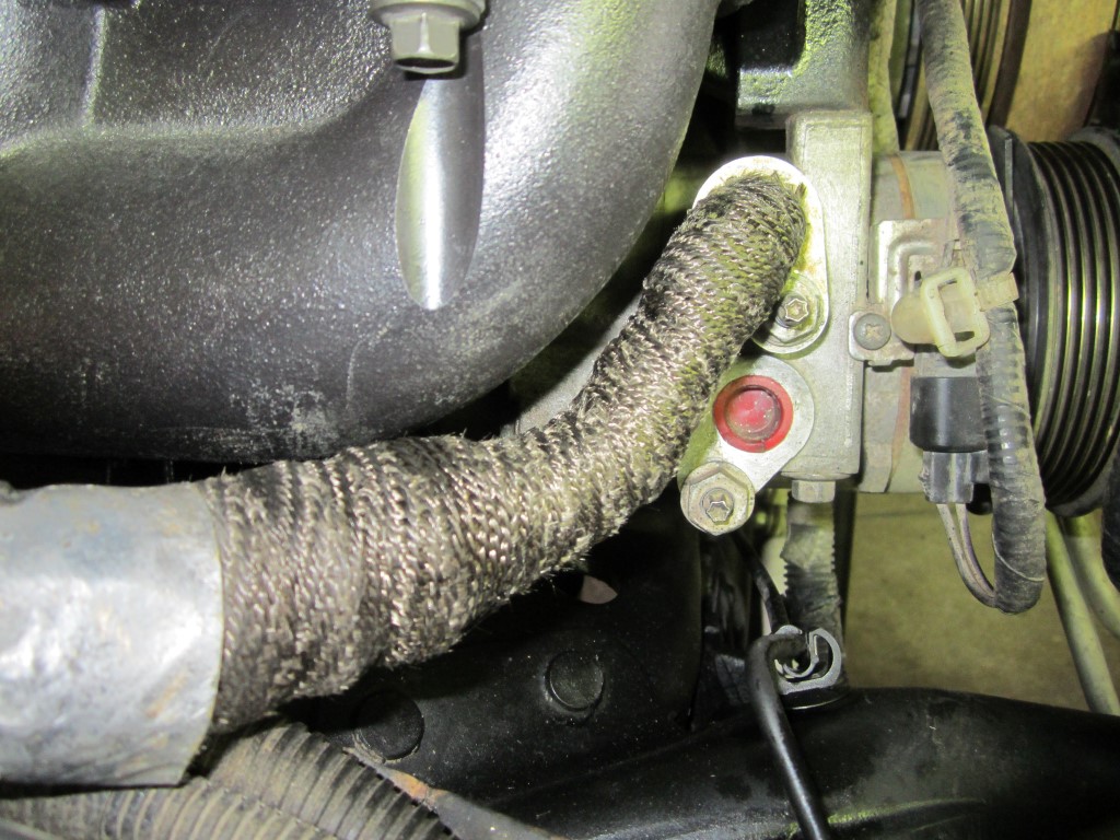

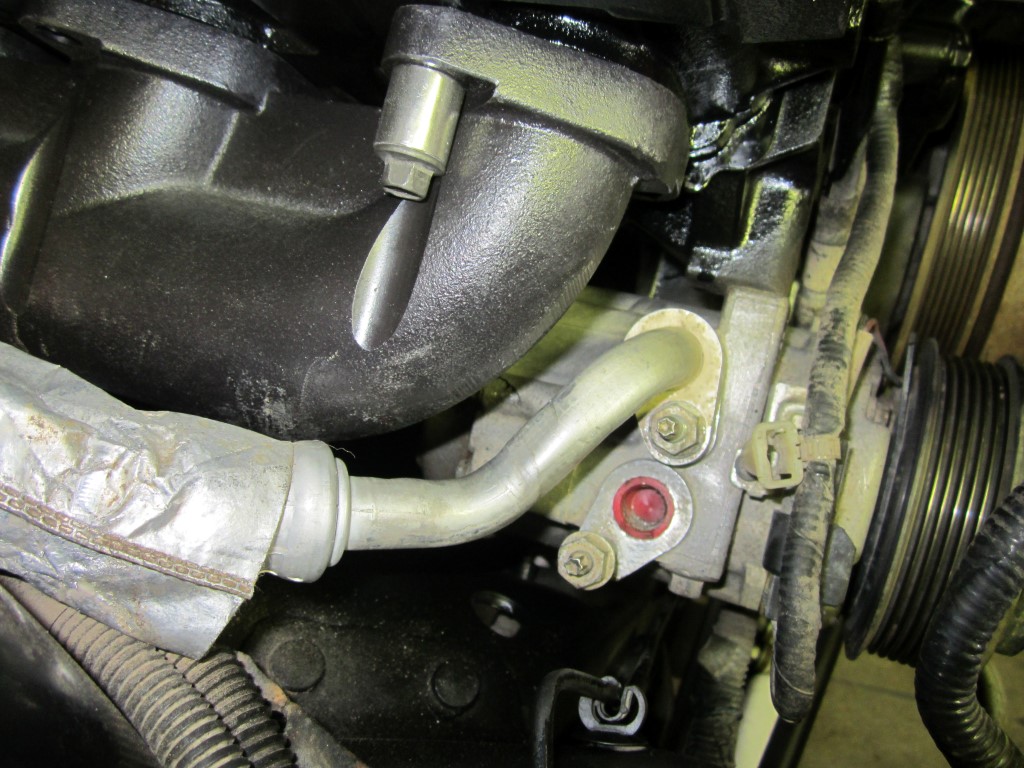

Line is done.....moving on with the "to do" list
