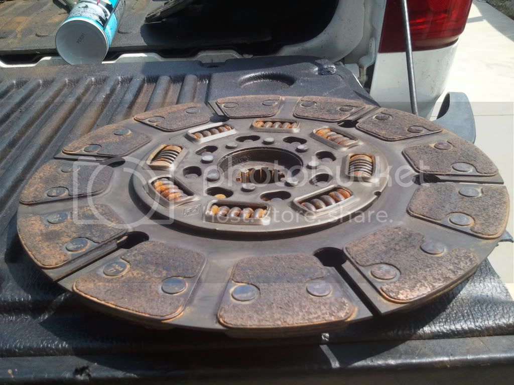

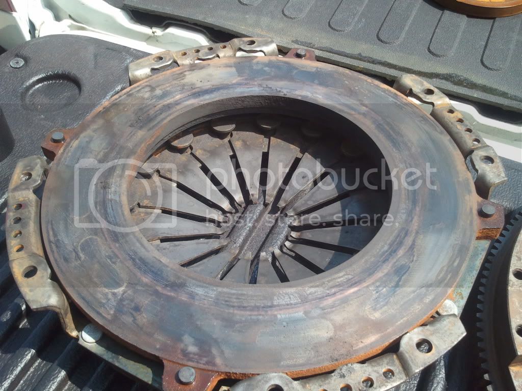

Below is what was left of my South Bend 3650....
I wouldn't recommend anything less than a 3650 from south bend. I am currently running a 3850. Its a little tight for day to day driving, but i had no desire to keep replacing the clutch time and time again.
Spartan 310 Tune, no air or fuel upgrades.

When was that 3250 purchased? Did you go to Southbend and ask questions? That is a 750hp rated clutch, so unless a ridiculous amount of miles were put on it....it shouldn't have worn like that.
How many miles were on it?

South bend helped me out a little with the rebuilding it to a 3850. It was purchased in Feb. 2011, went out May of 2011. 3850 was installed at that time. That 3850 had some issues and was replaced under warranty in May/June of 2012.
Truck was purchased 10-31-2010 with aprox. 35K on it. Truck currently has aprox. 58K now.

I would say there has got to be some other contributing factor. Have not had any problems with any SB dual dicks in a 6.4. He'll I leave the line @5500 rpms in my pull truck making over 1k hp at the crank and all I have is a 3850.
For a stock truck to do that either it isn't installed right, something's wrong with the truck/trans or the driver doesn't know how to use it properly. And that's not an opinion. A stock 6.4 doesn't just tear out 750hp dual disks for no reason.

I aint no expert but that sounds right to me. I can't imagine the kind of abuse it would take to tear one of these up.
