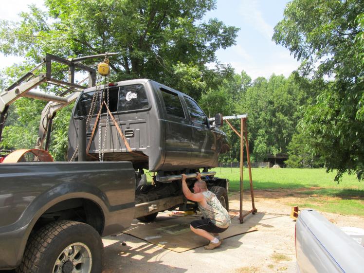

I did a write up years back VERY thorough. it's on powerstrokenation I believe. pretty sure I was the first to do it. let me know if you want h-13 studs , low torque, same clamping force as h-11, and not one cracked block after 60+ sets sold.
08Monster
Sep 8, 2013
1,871
If you would talk me through the install if I have a question or two, I'd buy your H-13s. Customer service alone is worth the price. :)
