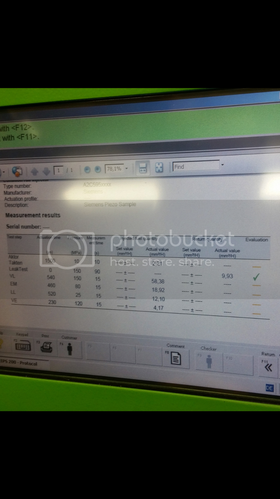

I believe we have the best of the best testers out there for common rail. When I have 6.4s flowed, I get a sheet back for every injector going through 5 different stages and testing points. So it can be a matter of pass or fail, depending on whose reading the numbers
DEEZUZ
NO PUKESTERS
Jun 30, 2011
6,859
194
NWI
Screen cap off our Bosch
Now to average Joe, these really don't mean much, so yes I can understand how one can say either 'pass or fail'
