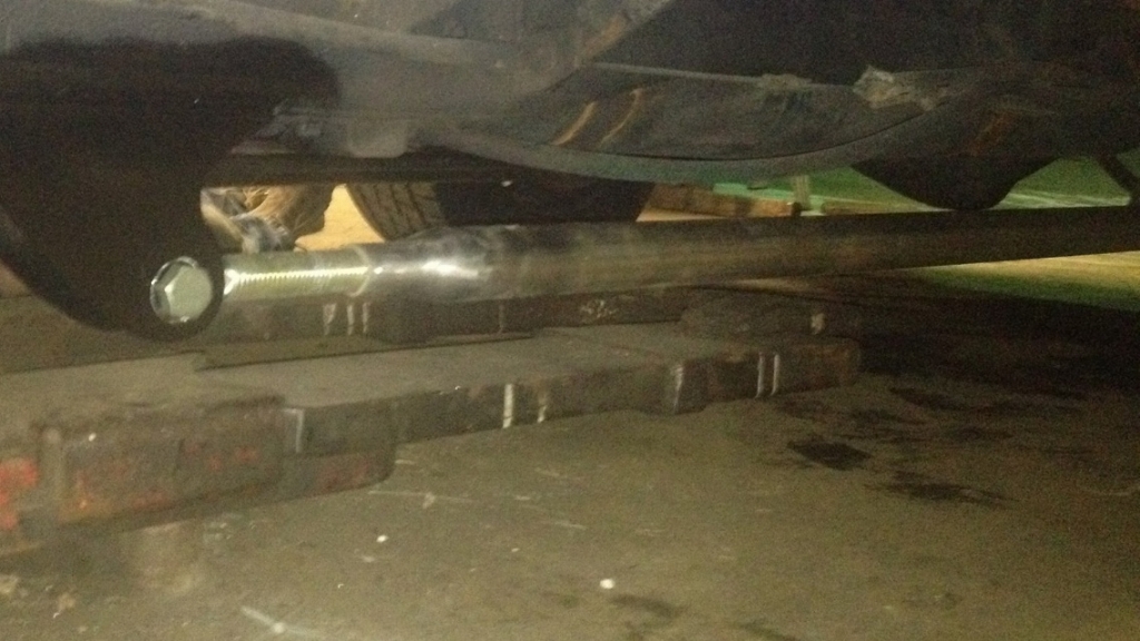

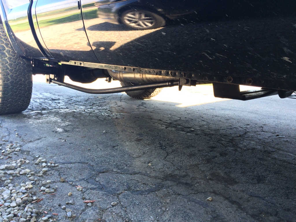

Well after a long day of working on the truck yesterday, electric fans, air kill system, trans blanket, cross bolts in downpipe and driveshaft safety loop all installed in one day, finished half an hour before the pull and made it just in time. Hooked in the pro street diesel class, ended up being test hooker again, pulled 305' for the first pull, but bent my traction bars and stripped one if the heim joints so I turned down a re pull, tightest track of the year cause it was so cold out. Truck worked good though, waiting on some videos. Guess I'll be looking for some new traction bars this week.

what size is the tubing you used in them?
Not sure, bought them thru a buddy who had them made by a guy north of me, they were cheaply made but seemed to work, first tight track I've pulled with them on and clearly they didn't hold up..just bent them back up with a jack for now lol

X2 on OUO bars.....love mine.
But since your brackets are set up for heims Get ya some 2" OD .250 wall DOM tubing.
Weld in threaded bungs and some currie rod ends.
That will not bend.
You can get everything you need at
Polyperformance.com
I can post up some pics of what I'm talking about if ya would like

Thanks, a local guy makes these for $250 installed, or they make ladder bars too for more $$ but he said the single bar will hold up, anything is better then what was on there

The ones that were on there had rebar welded on the insides of them...hated those traction bars anyways I'm glad they finally bent so I can get a better set lol
