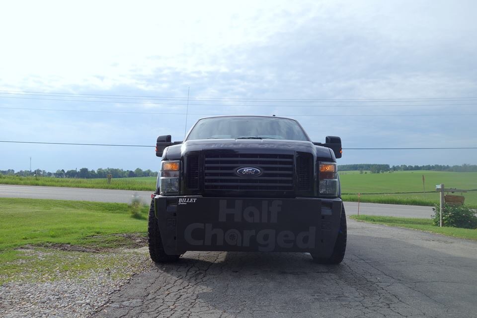

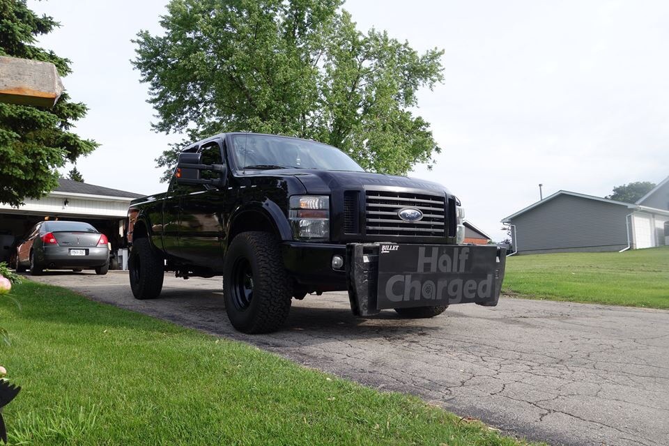

holy big weight bracket. how much weight can you hang up there and be legal? looks good though!
live life full throttle
Yeah I may trim the plate down it turned out pretty big but I'm hoping once the logo is on there and it's painted up nice it'll look better on the truck. I only have 400lbs of weights right now I should be able to hang this season, we built it to hang 4 weights off each side so 800lbs but I'll most likely have to remove back seat and tailgate to be able to hang more then 400lbs.

ahhh 10-4.. i can only hang 300-400 lbs depending on whos scale i am on so i just made a bracket that holds 5 suitcase weights and to bolt to the drivers side tow hook.. my truck rasies the drivers side bumper like 6 inches without weight. about 2 inches with 400lbs on it..

Yeah we're an 8200lb class the truck weighs about 7750 right now with no weight added. I may be running duals on the rear once I get a trailer to float it to the pulls, I'm one of only 2 trucks in the class now not running duals lol

yeah, thats the same weight class i run. my dually is gutted and can only hang the 300 or 400lbs. thats with a 1/4 tank of fuel.. lol she's a heavy bish..

Just a few small things left to do and a good once over and she's ready to rock tomorrow night, hoping the rain in the forecast will hold off!
Did the logo up myself, not perfect but it'll do for a few pulls.

On a side not the truck weighed in at 8320lbs with me, full weight and interior, all my tools and supplies and 4 100lb weights off the front, and half a tank of fuel, had to take 1 weight off to be able to pull but I should be able to hang 4 no problem next time.
