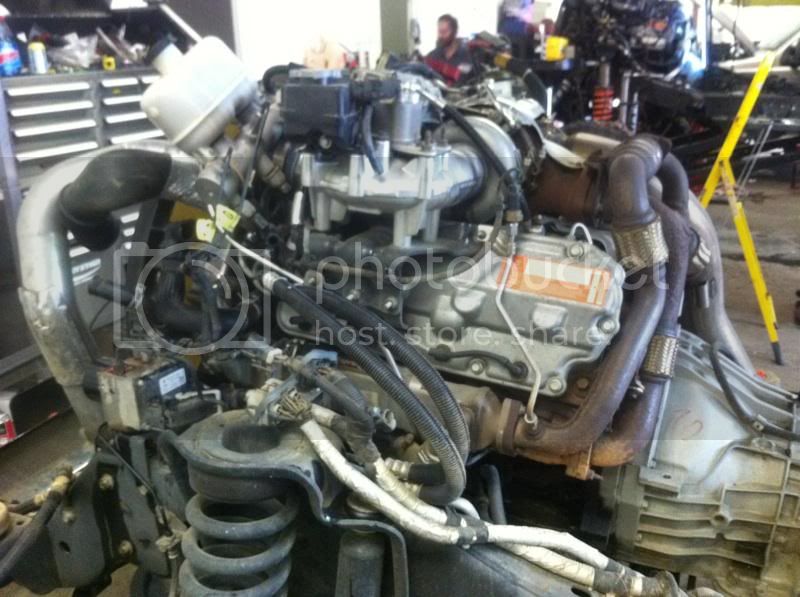

97f350stroker
Feb 20, 2012
1,509
Burgettstown pa
Found this pic on Google. Ebp sensor is in that egr pipe so if I got rid of that pipe I would have to move the sensor. Just drill and tap the block off plate?
