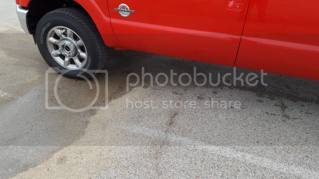

I was driving to class this morning and noticed my fuel gauge had dropped a lot. Thought that was a little odd since my 6.0 would go 350 miles on a tank and it was a short bed. I pulled into the school parking lot and parked and started smelling diesel. When I opened the door I saw this.

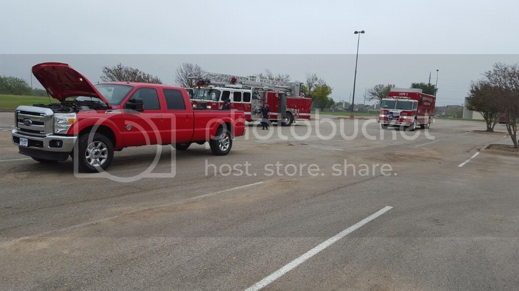

So I called roadside assistance to come pick this piece up. They dispatched the hazmat team. They told me a tow truck won't pick it up if it is leaking. and I had to get it verified that it wasn't leaking by the fire department before I could get it towed. I tried to explain to them it only leaks when the key is on and there is pressure in the system. But I got this any way.
So I am embarrassed as hell. Standing in the parking lot while the fire department and police surround my brand new truck. I guess at least they didn't lock down the school. There was a nice long stream that lead all the way across the parking lot. This would explain why I saw a couple of cars behind me turn on their windshield wipers when it wasn't raining yet. Nobody was kind enough to let me know I was leaking something.
