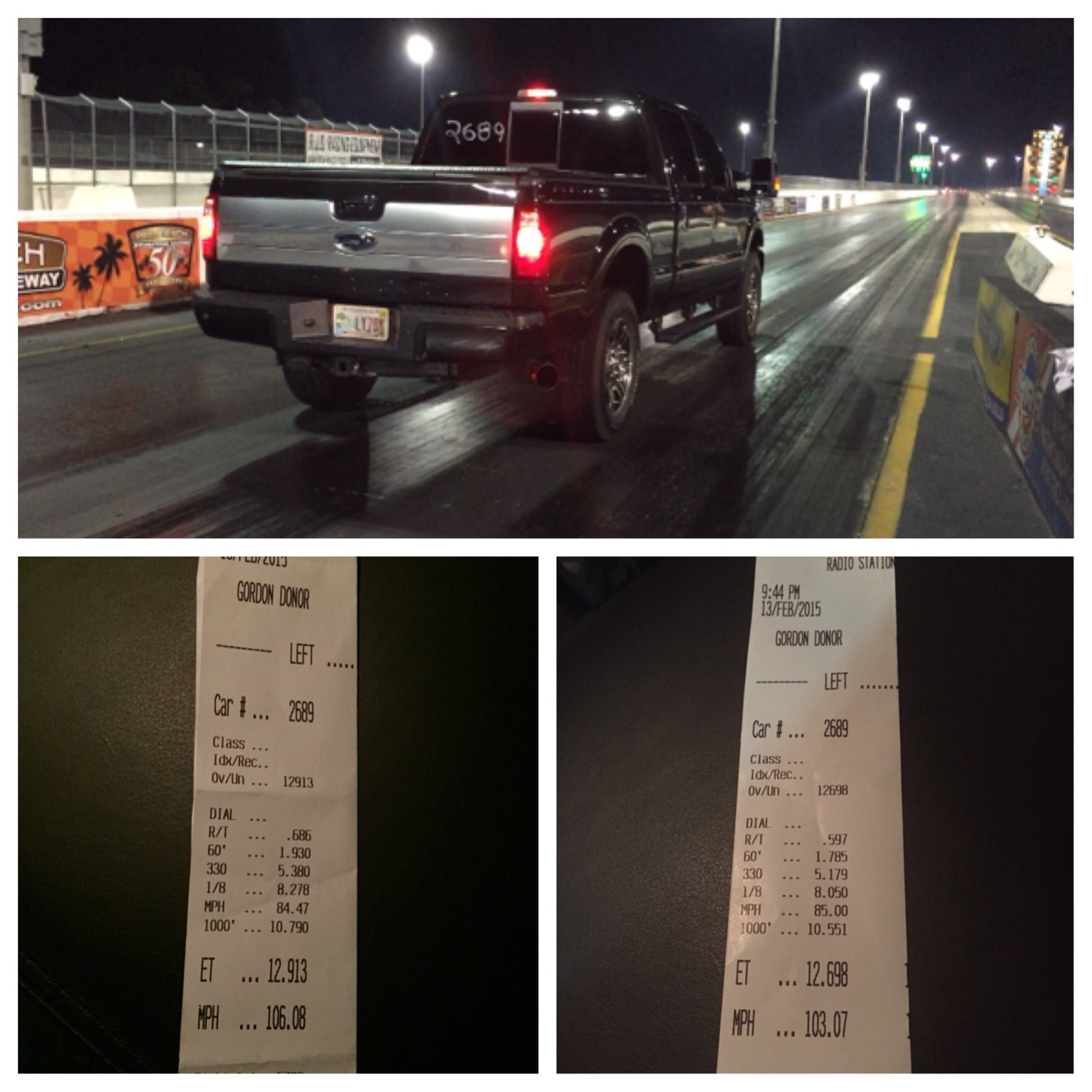

Skipped around this post but are these the times for the truck in your sig?
No that was over a year ago and 5 Turbo's ago. Last run a week ago I ran a 12.6
