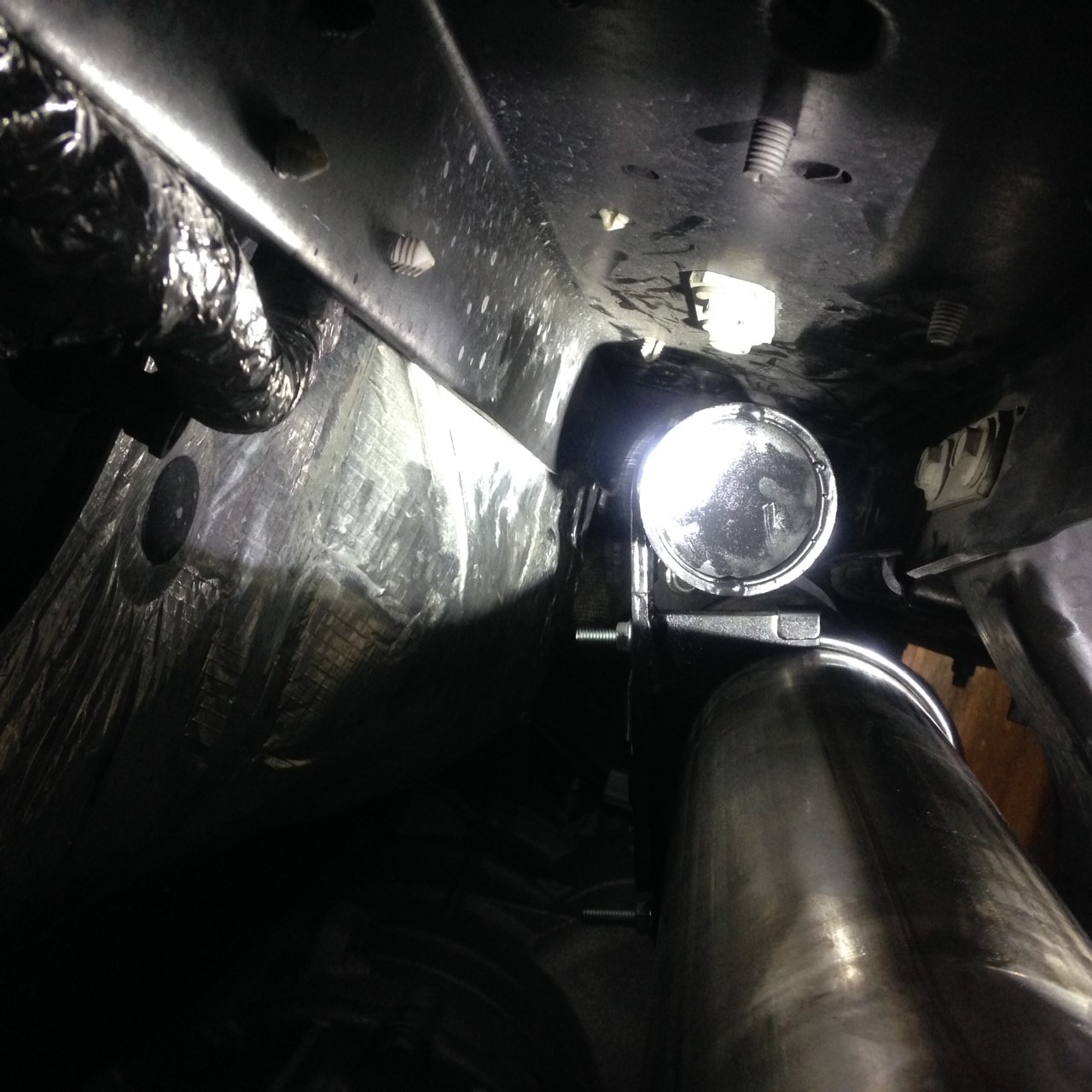

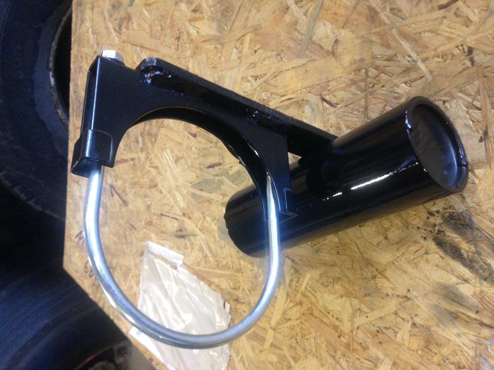

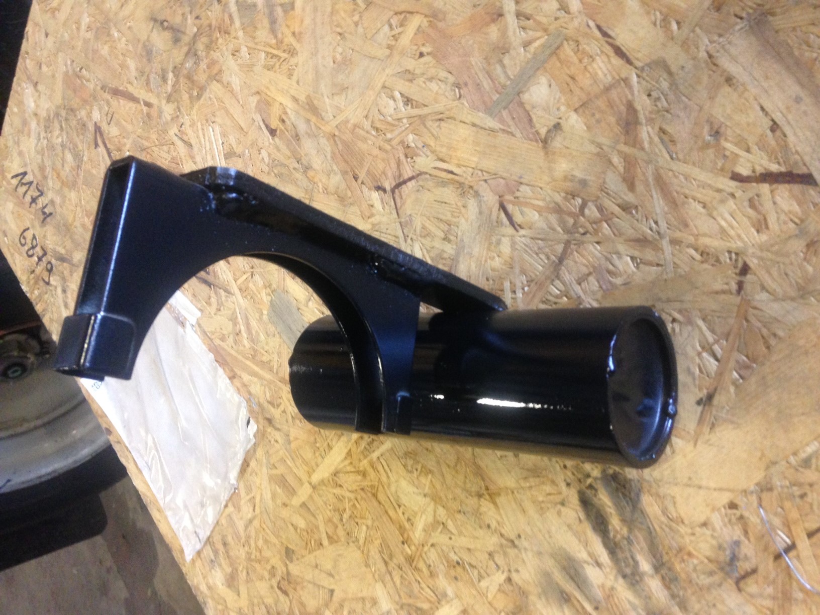

I modified the stock Exhaust Damper Assembly to fit my 5" open AFE exhaust. It cut down on most of the drone I had at 70 to 85 MPH when cruising. It move the harmonic to 65 mph but not bad. Took most of the off idle noise away from the front of the truck and moved the sound out the back. Took less than an hour but I think it was worth it. Put it in the same spot as the stock exhaust.
Lol. So thats what that thing was? Oops I just tossed it.
Where did you get that thing? Come with the kit? Hey Tadd wheres mine....??
it came on your truck from the factory. and launching in 2nd is just fine. im actually waiting for a tune that locks 1st out with the tow haul button.
