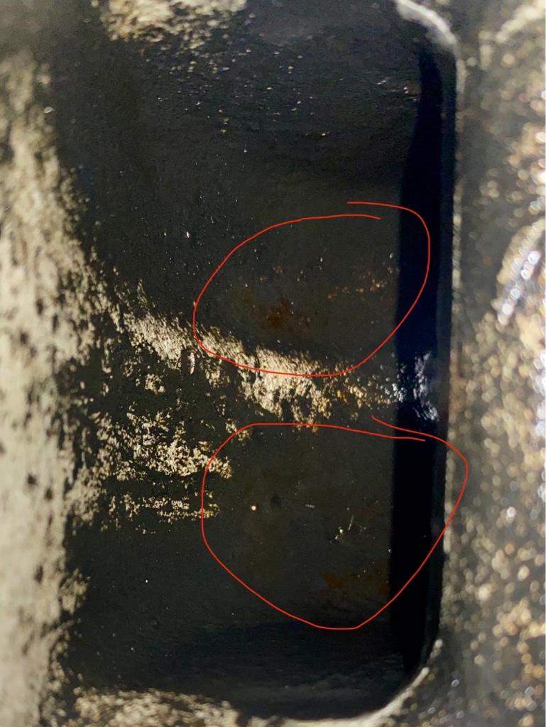

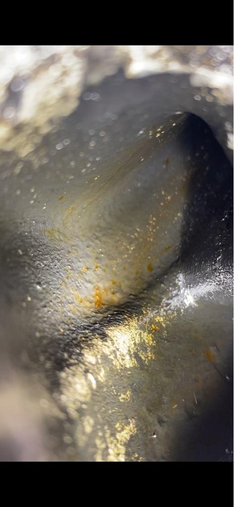

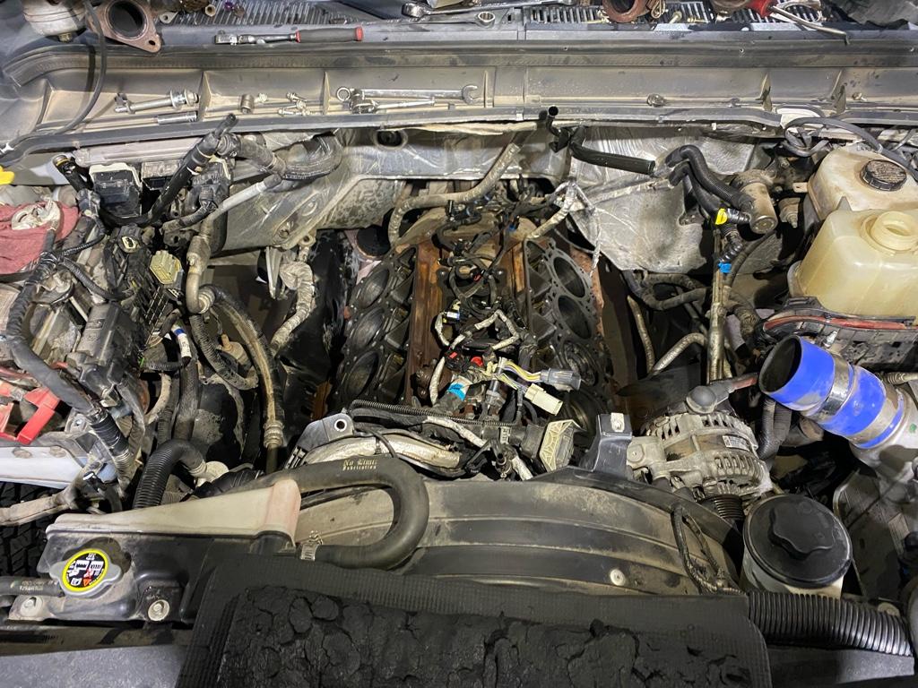

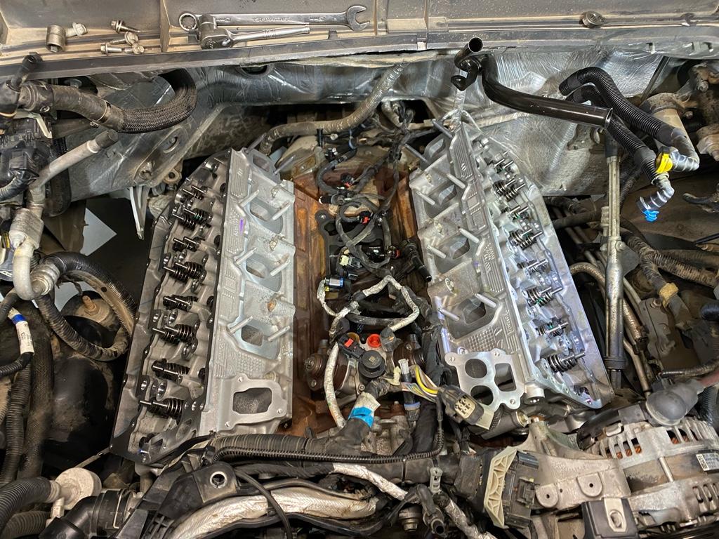

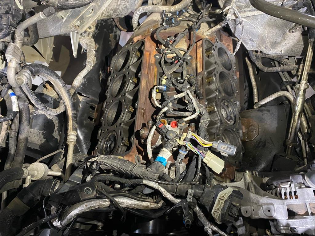

Pulled each up pipe off the see if one exhaust manifold was more wet than another. The left hand side had dried coolant built up around the edges. So I pulled the left valve cover off and found coolant inside #7 intake runner. Pressurized the system and left it overnight. The next morning I could see coolant had pooled up in the bottom. Couldn’t see up inside the runner enough to locate the crack. Ended up replacing both heads cab on. Really not too bad of a job. I really like working on these 6.7’s they’re quite simple. Enjoy some pics
Nice find man. You’re right, they ain’t too bad, but the 32 push rods piss me off though. Real pain in the ass to get everything lined up right.
Torquing the head bolts sucks!!!! I was gassed after doing that

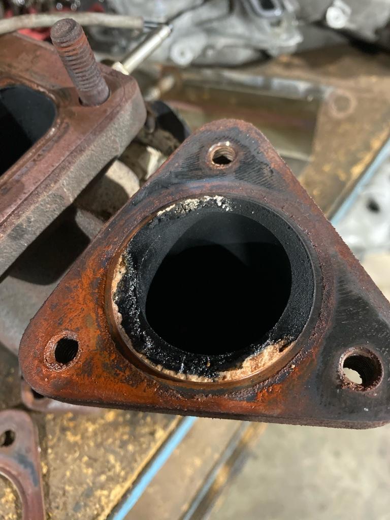

We got the 2011 f550 truck in the shop this week and found signs of coolant in the exhaust manifold and up pipe. This truck has a bd turbo kit so the exhaust manifold isn’t stock. Appeared to be coming from cylinder 8 exhaust port. So this truck will be getting a set of heads as well. The customer had previously replaced the heads because of cracked valves with the absolute cheapest Chinese parts they could find so thats what I’m blaming it on.
