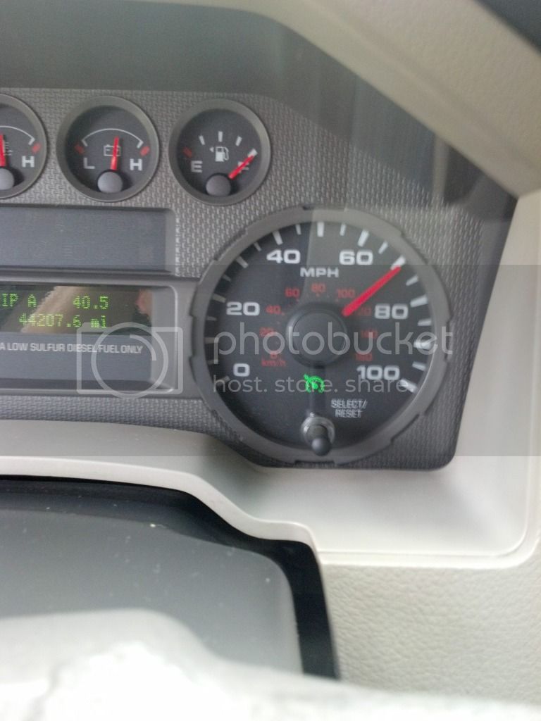

I can finally post this. Its nice to be able to use it again.

Always lol. I never go below half. Gets to much bellow that. With the drive out to PA and back i averaged 19.1mpg hand calculated. Pretty good for a 800hp truck. Im definitely lovin cruise with this setup.
