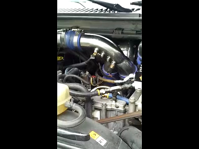

The sound in the video did not sound like it came from the exhaust. Like Dave said. Are you sure it not the flexplate? They will sound the same way when they come loose. We had one do that and we thought for sure the engine was toast!!! It sounded like the valve train was going to pieces and sounded like bent rods all at the same time. Turned out it was just a loose flex-plate.
Might be a cheaper and more easy fix then you think! Problems always seem worse when they first happen.

Well I'm really hoping it's trans related. It'll be a lot cheaper and easier to fix. Basically it does that at idle and quits when it revs up. I didn't get much time to diagnose. That was in the parking lot when I got to work. I did notice though that it was shifting a lot harder today. I only did 2 runs at almost full throttle with no launch and no nitrous. Basically just what I did in the video above. However, that trans does have a whoooooooooole lot of track passes on it. The engine only has 98 miles on it since I put it in. Also, the flex plate is a billet ATS. I don't see it coming loose, but it may have. It could also be the torque converter. It runs fine though. I guess I'll pull the trans too when I get ready to reseal the fluidamper and put the wastegate in. I need to do it soon. Only 3 weeks till TS and I may need to make a trip to Leadhill Arkansas in between there.

hope it is only the flexplate or tc... easy fix.. im sure the bolts are still tight but the last one i heard like that, the flexplate wasn't connected to anything cuz it broke around the outside of the bolts.. pulled trans back and it almost fell out on my cousins head. he actually had a tc laying there to put in it cuz they thought it was the converter... did the same as yours, it would go away under load or revved up...

I've broken 2 of them myself. I hear what you're saying, but it's a billet flex plate and I couldn't have pushed more than 600-650hp to it twice for about 10-15 seconds.

got ya, prolly tc then... but like i said my speakers are ****ty.. and ive seen weirder chit happen... just cuz its billet don't mean its unbreakable.. either way hope its something simple...

Have you looked at the TC/flex plate yet?
Loose bolts between the two sound like a broken flex plate.
