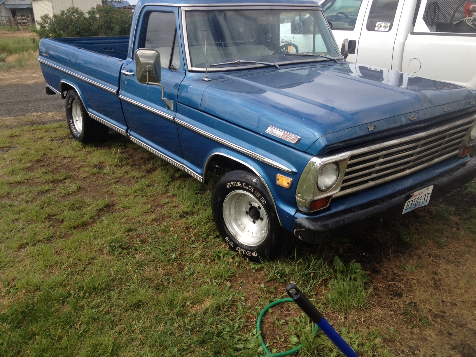

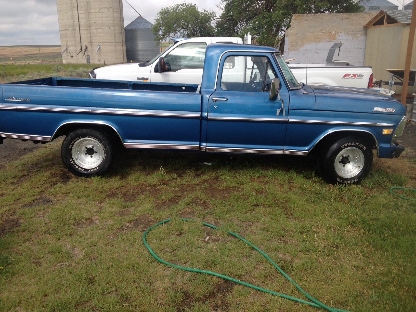

Bought this the other day as a project to do with the kids over the next few years.
Looking to swap in a DT360 with a 4 spd auto. Is there a non electronic 4 spd auto that will bolt right in?

What a horrible body style of truck to do a diesel conversion to!:puke: You must be crazy:lame2:
Just kidding. It should be sweet when done. The truck sure looks clean in the pics.
chris1978
424
Kamloops BC Canada
That is going to be a really sweet truck. I've thought about trying to find one like that and going with a 12v in it.
Thought about that route too.
Super straight body. A little bit of bubble rust on the box but nothing serious. Interior is chit but thats all coming out anyway...
Gonna call Carson on Tuesday and see if there is any trans I can run behind it without running adaptors other than an Allison 545 non lockup non od trans.

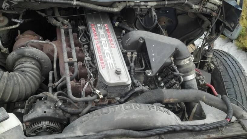

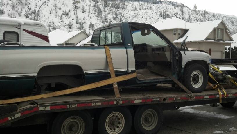

And plans have officially changed. Picked this up yesterday
Sent from my XT910 using Tapatalk 2

Too late the donor truck is already bought. Anything with a DT360 around here they want my first born for it...
