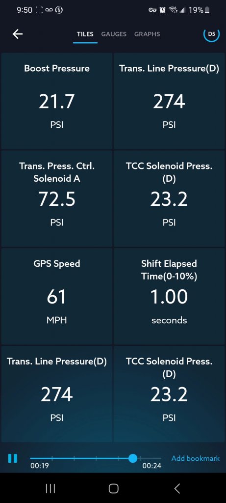

2017 F350. Tuned/deleted. Guy who did the tunes has gone dark, its possibly running PPEI tunes, not sure on trans tune.
Truck has 66k miles on it, tuned since about 25k.
- New valvebody (~50K miles, dealer installed)
- New drop in ford reman trans (~59k miles, dealer installed)
- It was running 37x13.5s for a bit, owner has since went to a 295/R18.
5th - 6th its giving a nasty shudder/surge feel, but no squealing. Fuel rail pressure is fine, making me believe the valve body can't hold pressure or the OD clutches are already slipping.
I ran a few logs on it using Ezlynk. When the TC is locked, its demanding ~275 PSI line pressure.
I'm used to the 68RFE where I can monitor demanded vs. actual, is there a PDI I'm missing on Ezlynk where I can see this on the 6R140?

I agree on the tuning, who's ever it was is garbage.
What I am trying to figure out now is if the tuning has already ruined the vb/solenids or 5-6th clutches.
Is there anyone I could send some logs to to verify if this is the case?

The dealer did all the work, and the truck hasn't been touched with a tuner after either repairs.
But what I am confused if what you say is true, why it is it still demanding 274 PSI?
Screenshot of data log at 3/4 throttle attached...
Honestly, I’m not a trans guy, and when I do try and diagnose them I get lost, as desired and actual never really seem to make sense or match.

I get it, truck needs better tuning.
Better tuning won't fix slipping clutches or a failing VB, tho. I want to verify there is no internal failures before tossing new tunes at it.
Does anyone know anyone who I can send some tuning data logs to?

Update.
Went with some Alberta flavored tunes and it totally resolved these issues. Feels like a different truck and the exhaust brake feels almost similar to a Cummins.
@lincolnlocker not sure how recently you've used their tunes, but I got bad feedback from a few of their dealers regarding recent support and tcm issues. Dirty said they can't remember the last time they've sold a proven package.
