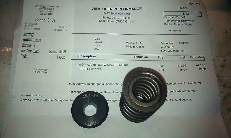

These springs are the ones you want. Call Crower @ 619.661.6477
Here's the quote from WOP about the springs from back in the day:
"Hey Timothy-
I spoke with the spring manufacturer and got the specs on those springs.
Seat pressure is 145
Installed height is 1.935"
Coil Bind is 1.070"
Zane says there isn't a big enough cam in the world to send those springs into coil bind. Those are the same springs we run in our Dragster with our performance race cam and it's been over 5000rpms with no valvetrain issues."
