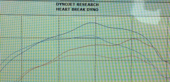

Blowby
1,532
Jason is correct with the modified cam I can tune the TQ down ...red was best HP tune and blue is new tune, first run with changes.
Red is the same tune above in blue. And this blue is best HP tune with reduced TQ.
