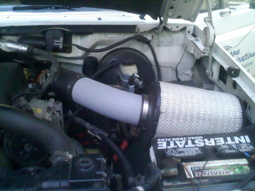

Well I'm glad to report my problem was solved. It was the garret boot going into my turbo. The boot was sucking the boot closed. If I would have thought of it when I would have checked that first as my first problem was because the filter got clogged. So it makes since it was that. Do any of you know where I can buy the boot? Thanks for the help guys.

Just get a hunk of 4" pipe and a donaldson filter and be done with it. Glad you found the problem.
Make it look something like this:

Being my truck spends a lot of time on dirt roads and it was an oiled filter. I assumed that being it wasonly 3 months old it wouldn't have been a problem. We discovered it was the problem when I took it off to clean it. I have had a k&n do the same thing happen a year or so ago. This one was a cheap one that I thought was similar to a 6637. I'm usually pretty good about maintence, and anyone who knows this is odd. I was looking at a buddys ats housing with the boot today, they put a ring around the center of the silicon boot. So I'm thinking this isn't the first time it happened.

Yes I do and when I get home today I will show what it looked like. After a 12hr day in the fields I was driving it home with a trailer and felt a loss in boost. It was a 3hr drive at night so when I stopped to fill up I looked over it all and couldn't see a problem. When I got home that next morning and pulled the filter to clean it. That's when I noticed it was clogged. I think in part the boots soft spot is right where my uppipes were leakin and there was soot all over it. The heat was another factor. I had my brother who has been wrenching for years look at it and you couldn't tell unless youflashed a light in it. It looked a like dusted but nothing major. The whole reason I replaced the last one is it looked clogged. I normally replace my filter every other oil change. This was my first experiance with an oiled filter. Like I said if you knew me you'd know this is an odd issue for me.
