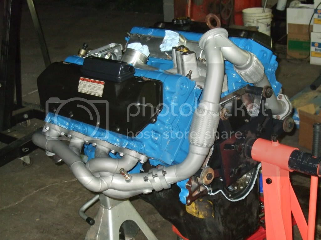

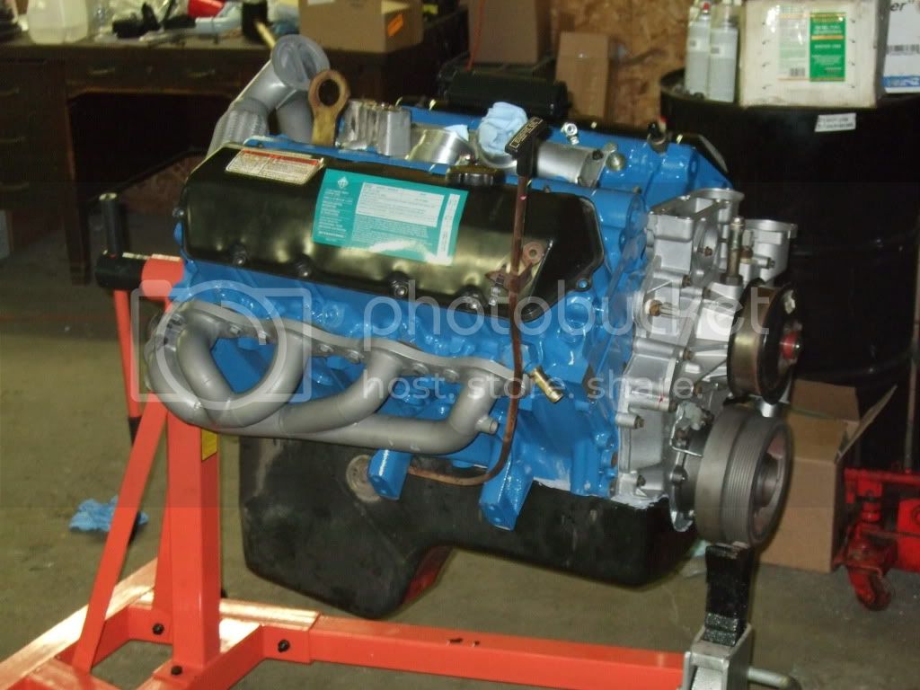

There is no way they could be made in one piece. These are DI headers, and their stock style uppipes with bellows;
They have around 40,000 miles on them now, on 2 different motor builds. No issues.
They do sound awesome IMO; Headers, 5" exhaust

If it was a true 1 piece unit you would either have to lift the cab or pull the motor to get them on and off. There isn't enough wiggle room to get the manifold/headers and uppies on and the same time. Every move you made to get one part on or off will hinder the other section.

it is a thought ill give you that.....if the uppies and headers were one piece youd have to have the whole contraption approach directly from the rear.....there is no other way to make it happen so its either pull cab or pull the engine......dont know how many times youve had your uppies out but yanking the motor or pulling the cab everytime would get real old real fast.....not to mention if you changed turbo setups you would also have to change headers....
edit: dang you guys beat me to it.....

Expanding on the last 2 posts. On the drivers side header, 2 or 3 of the bolts had to be started with the headers away from the heads because their wasn't enough room between the flanges and the pipe for the entire bolt length.
