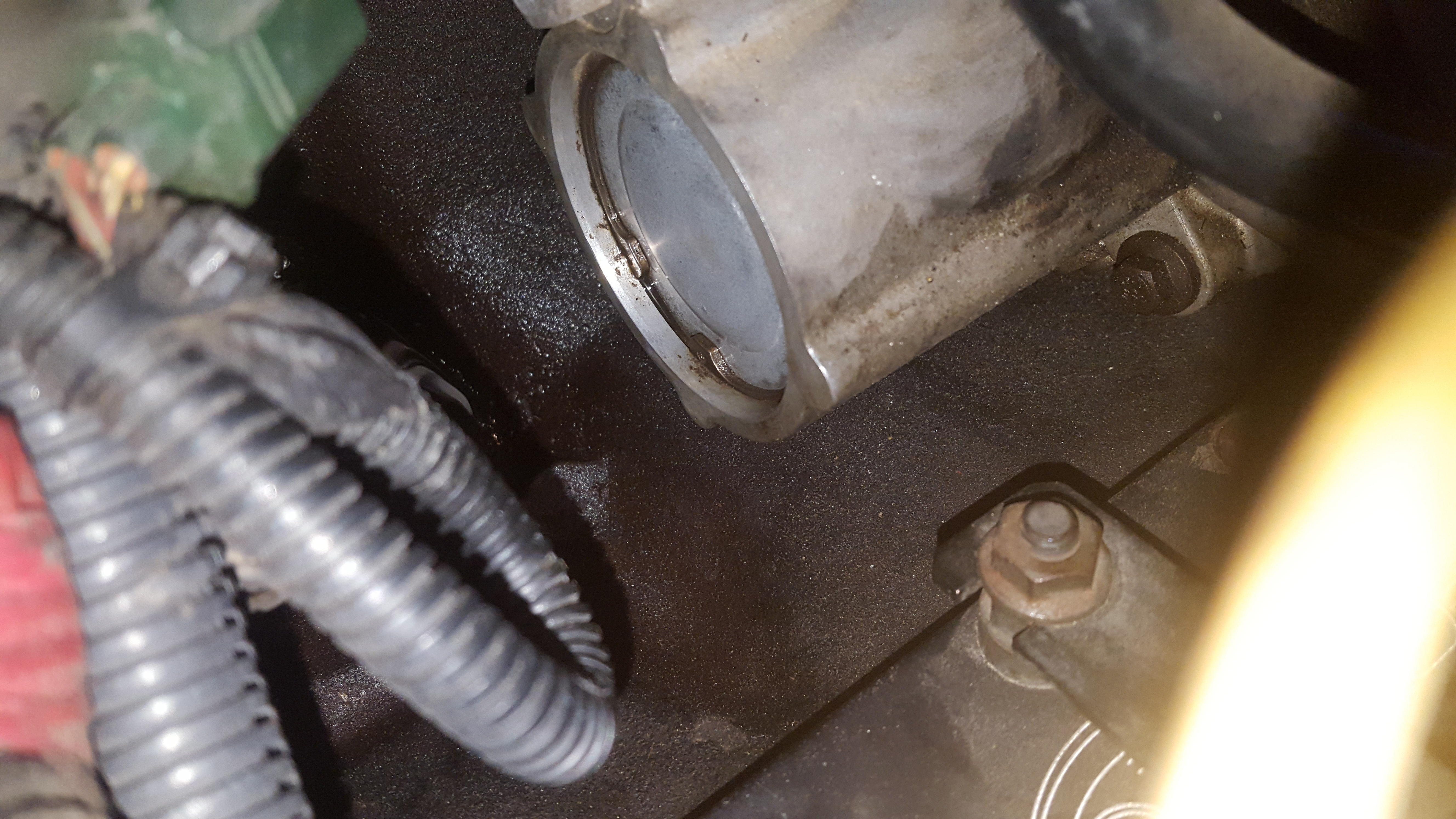

I am having a small puddle of oil in the engine valley. Is it possible for the back of the hpop near the c-clip be the leak point or source? Has anyone else ever have a similar issue? Thanks in advance.
Hopefully the pic came through. If not I'll try again.

Mine was weeping in the seal between the HPOP itself and where it mounts on the block.

that o ring is available from dieseilorings
that must be an srp as that is the only pump to ever leak there...

too funny. I dont think it could be an srp. As far as i know this is the stock pump. The previous owner only put rain gaurds on the windows as far as modifications go, ive done everything else.

I was gonna call him out when I first saw that but it wasn't worth my time at that moment. My sticker leaked from there.

Yes it is. he is just trolling along.
you have to admit these guys make it too easy.
although I didnt see them speaking up in any of the threads slagging the srp in regards to them leaking from the rear cover (IMO srps came with a junk Oring and a smear of silicone, the dieselorings viton is what I replaced mine with and it was leak free with no sealant added)
