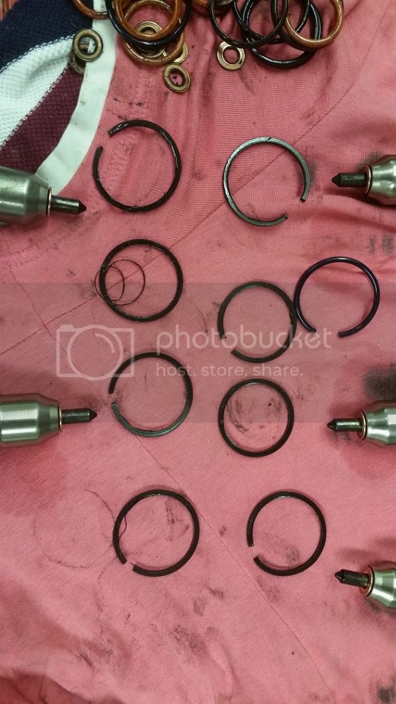

Really didnt want to start a thread but Its really irritating me now and I need help lol. Thinking injector o rings now? maybe a hung up injector?
