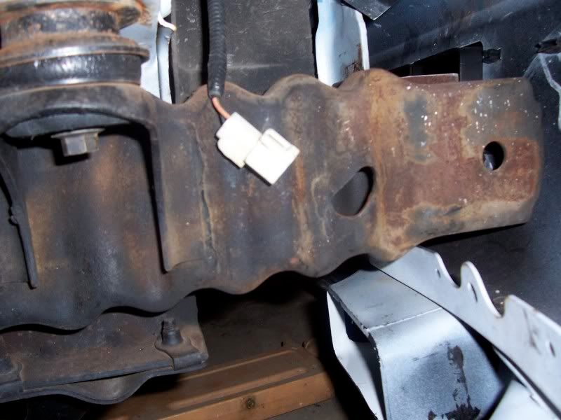

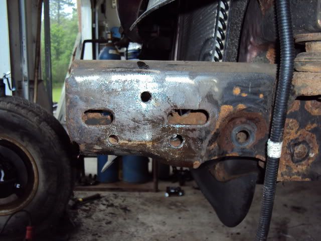

The F150/Bronco frame horns are entirely different than the F250/F350. Note the "accordion" sections.
F150/Bronco
F250/350
