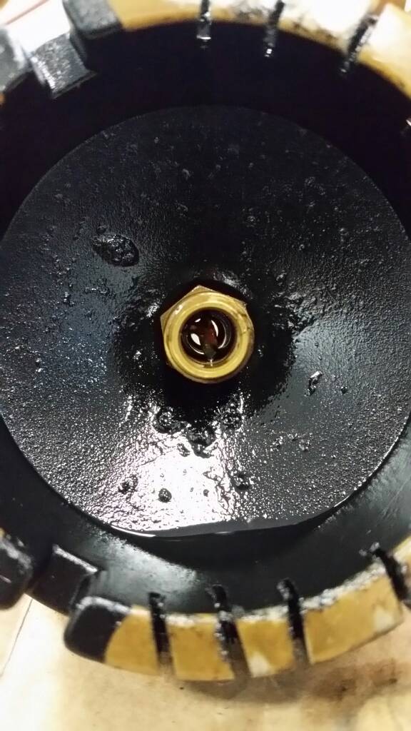

I'm going to say fuel pickup is getting plugged/restricted or fuel pump is on its way out.
Winner winner chicken dinner.
These are the internal screens right above the pick up. ******d them by doing the hutch mod.
The center piece is a tiny 1/4" not to 1/4" barb. The ash tray was quite loose sucking air.
hucorey
Jan 12, 2014
546
24
Defiance, Ohio
The owner of the truck told me that's what him and his buddy put in there. Not sure what the knife blade size slits are for???
He's a hot shot driver, so refueling I would hope is at any truck stop.
