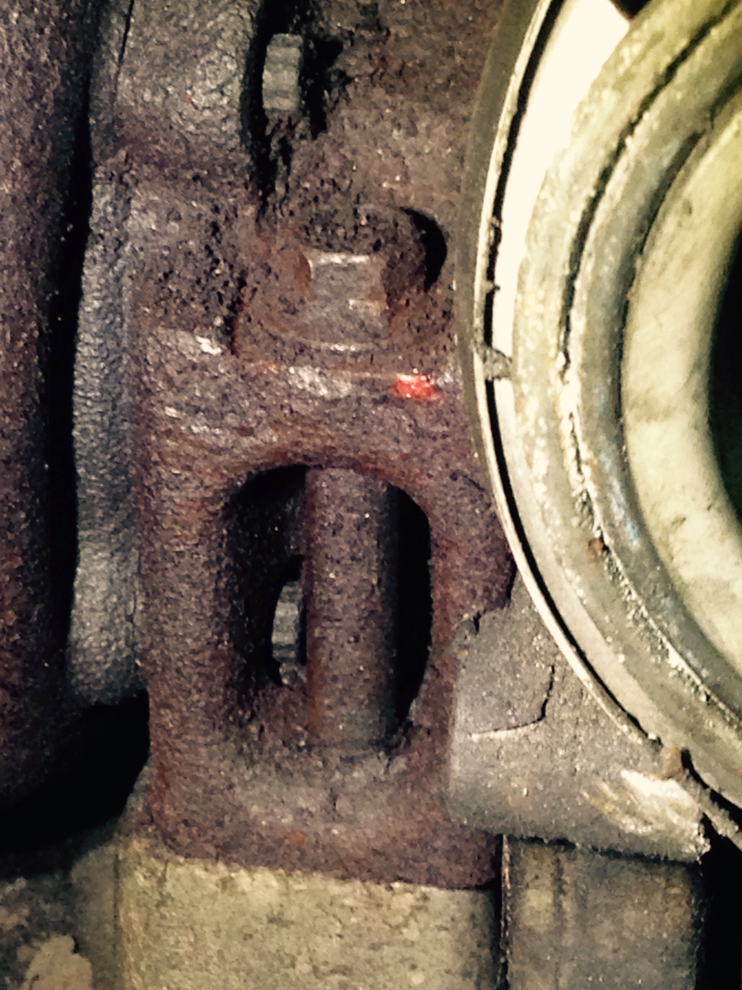

FullThrottleFarm
May 19, 2015
13
This is what i am dealing with. Soaked it in more smooz tonight. Try tomorrow.
