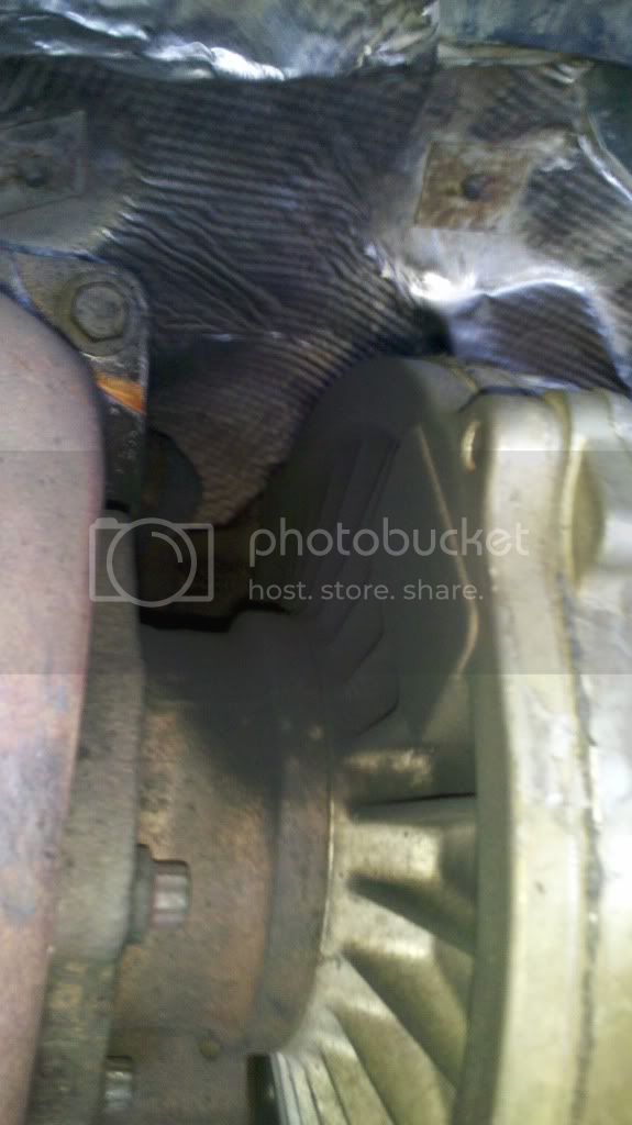

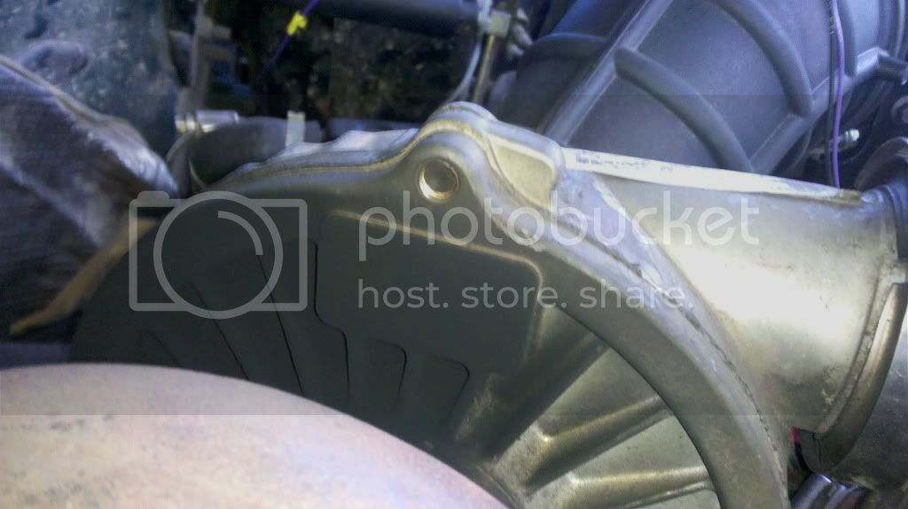

Okay so I shut my truck off and herd a tink tink tink from the turbo let it cool off went out pulled the boot... well I ran my fingers around the housing couldn't feel a rough spot but I did come up with a little bit of metal on my fingers.... also the turbo is covered in exhuast

Are all of the exhaust housing bolts in place and tight?
Tom S
3,365
Well you have a decent exhaust side leak for sure. I would also bet the bearings in the turbo are done and it is hitting the housing. I was wondering if the exhaust housing was loose and it was hitting on that side. Time for the new set up you have been thinking about?

That is what I would think to..

Yes you would need a new turbo.. Or to get you buy for now you could do a rebuild, with a kit you can get for 75 to 125 dollars..
A cheap way to keep the turbo going a littl elonger intill you have the parts for the swap you want to do..
