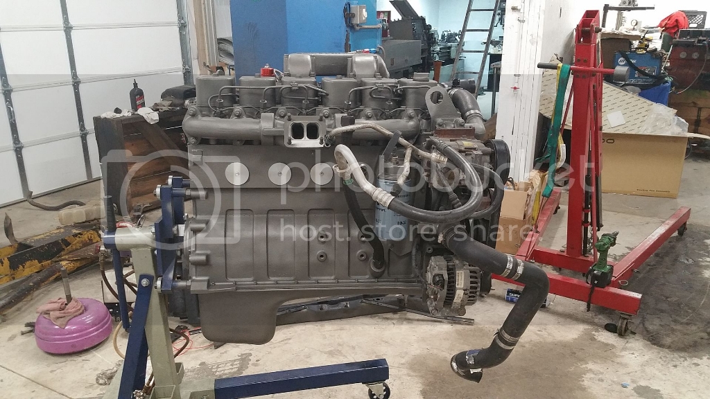

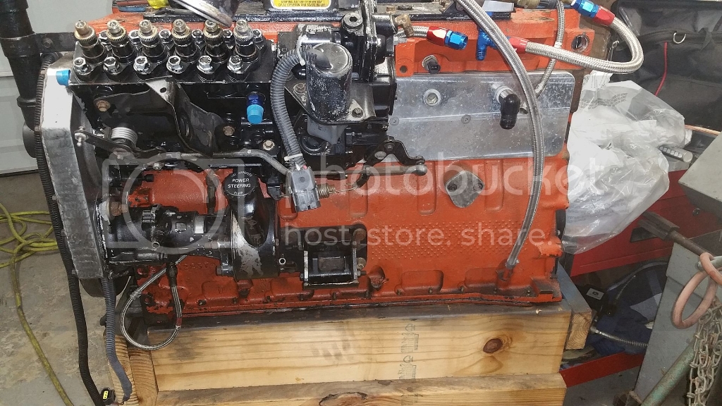

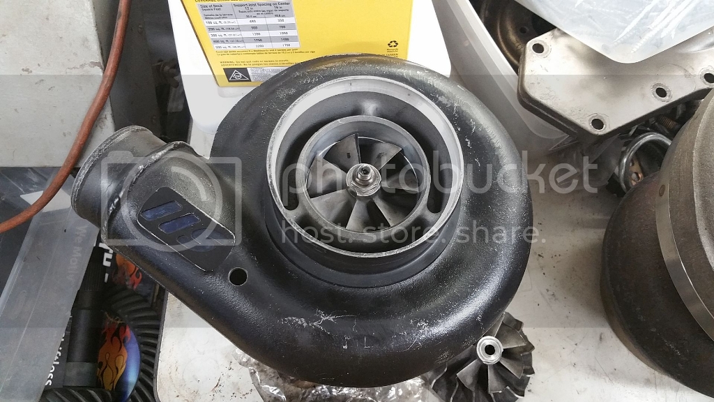

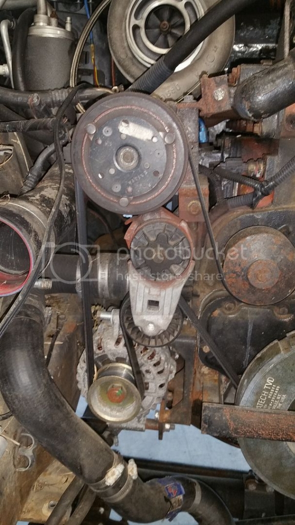

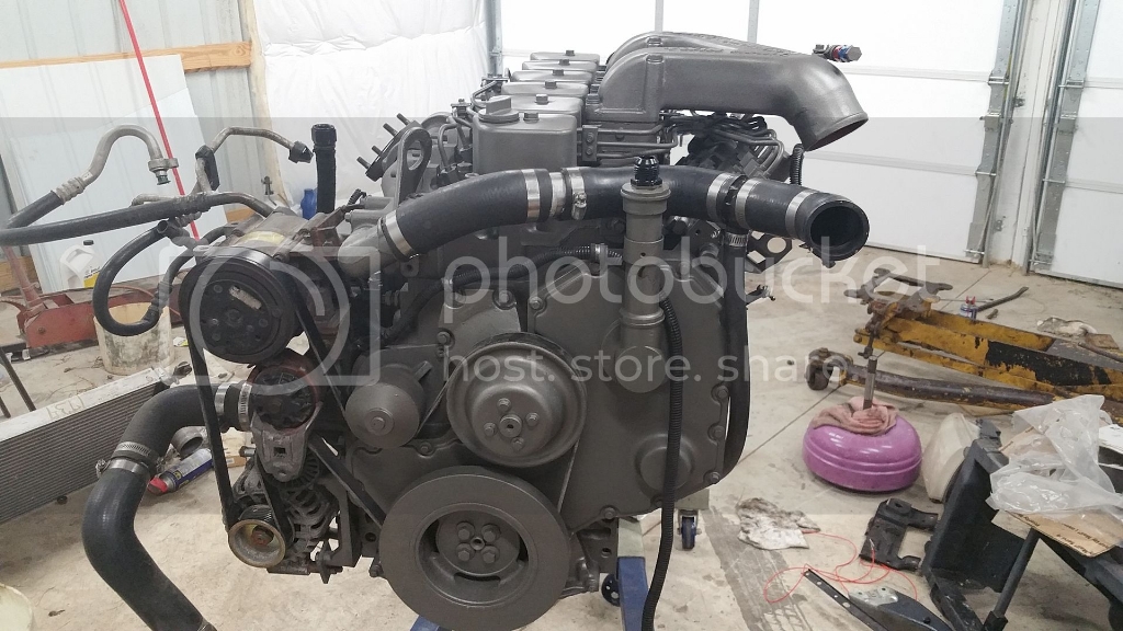

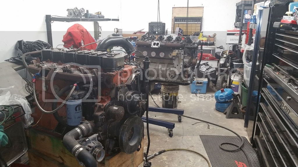

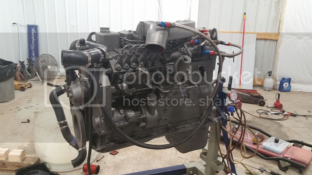

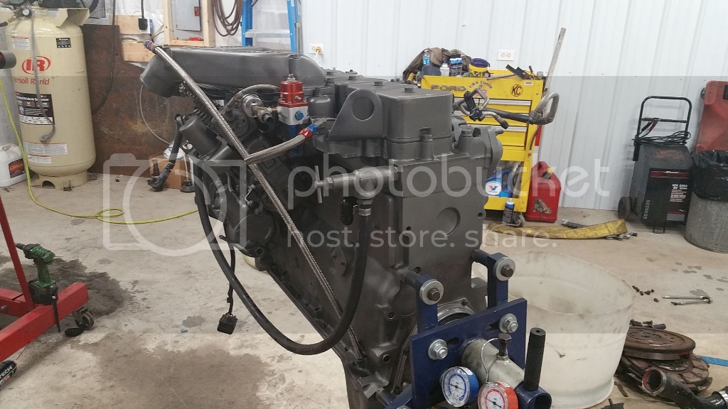

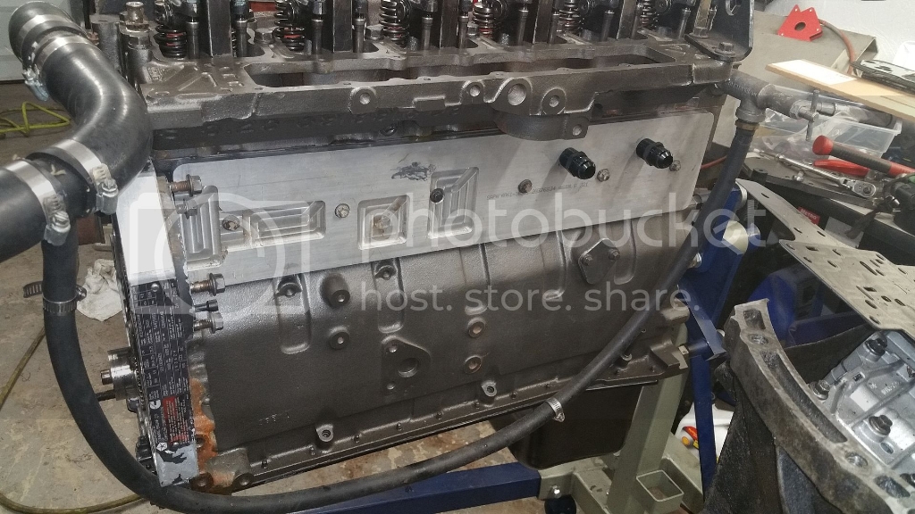

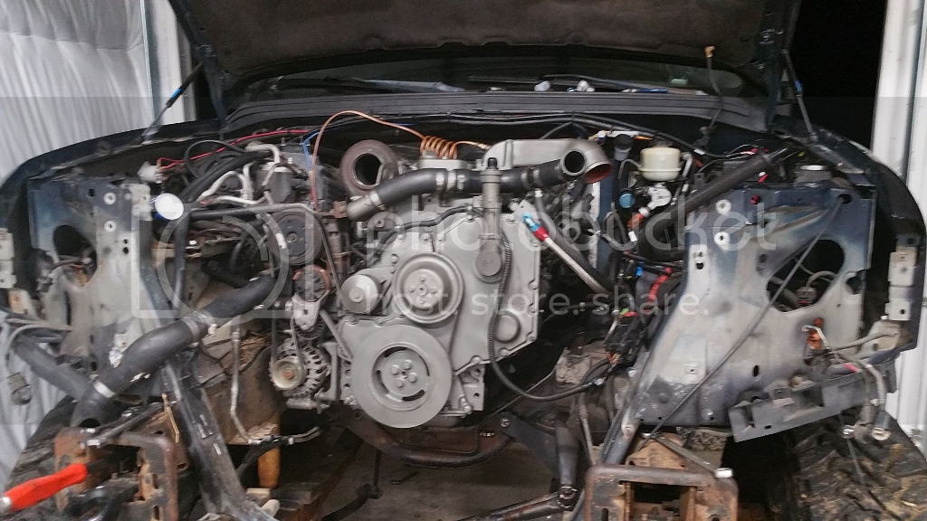

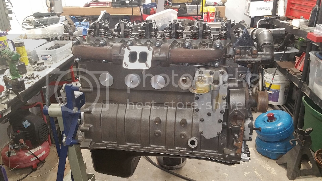

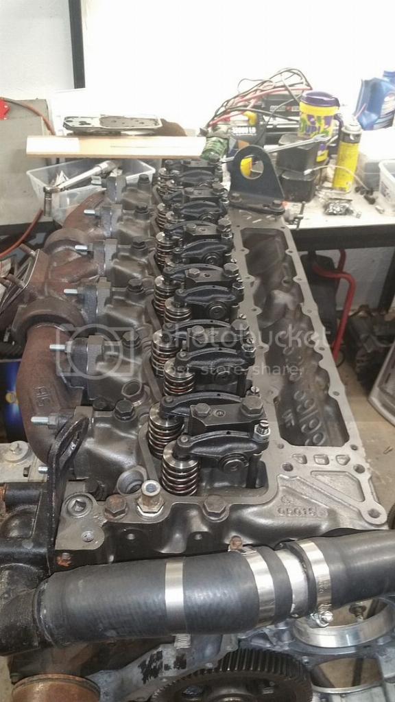

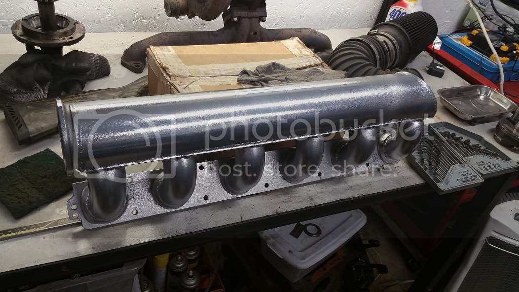

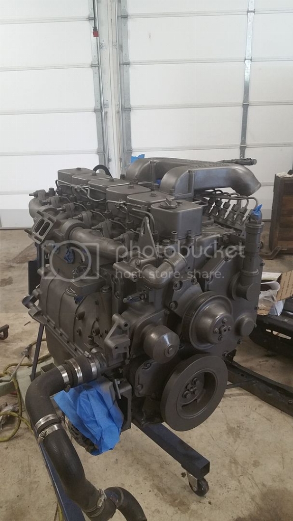

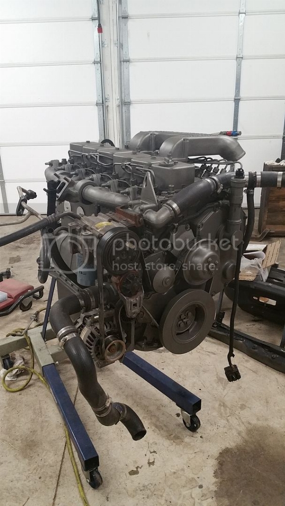

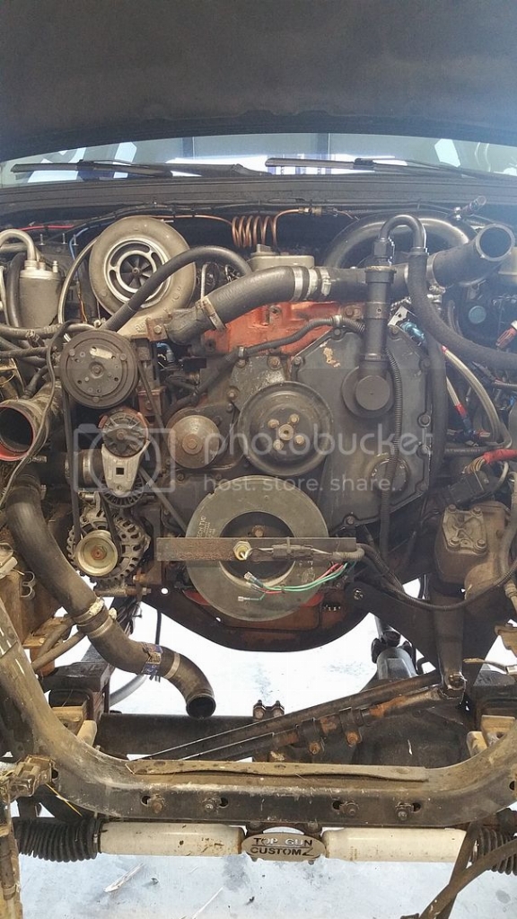

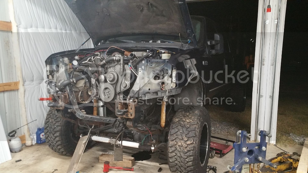

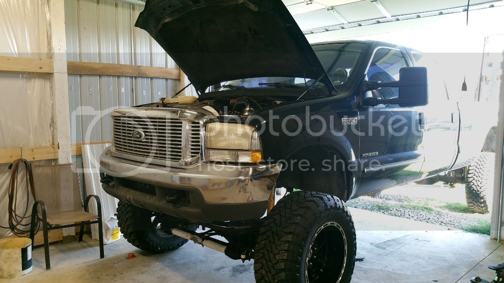

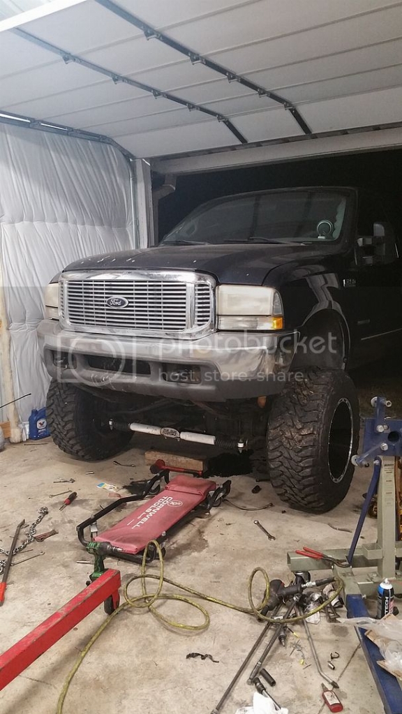

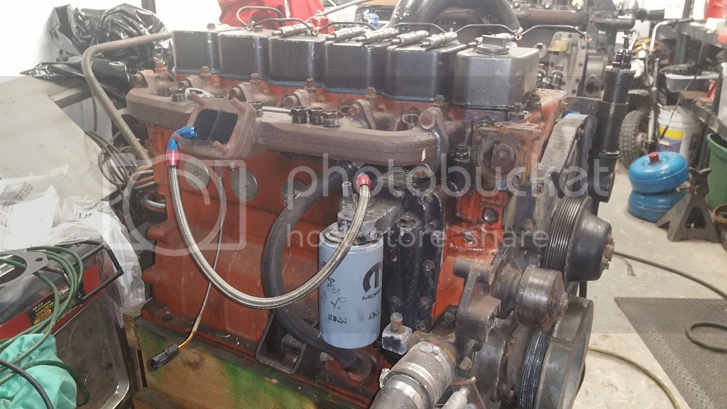

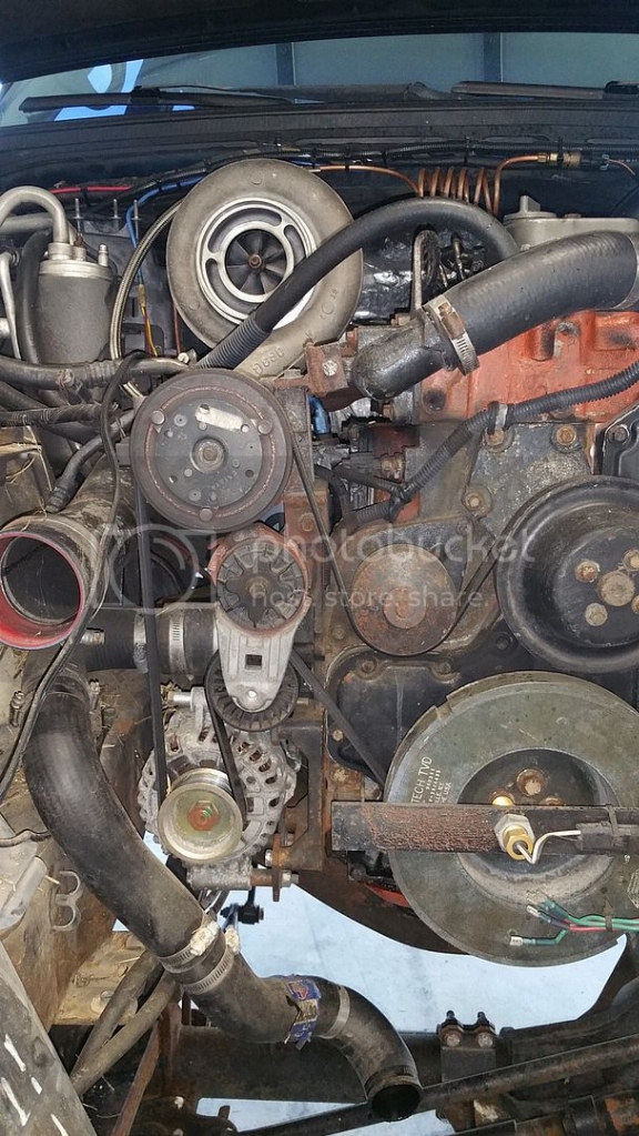

ok So I have not been as motivated as I should on my 95. I have been trying to get more stuf done on my shop and house. Along the way I have ran into more problem that have been deturing me from my goal. One week after the National Farm Show my 99 fummins developed a tick so upon investigating I found cylinder 4 with low compression. So I have pulled the motor and replaced it with another motor and now waiting to get the smaller turbo on and hopefully I will be back on track so with the 95. here are some pics of the work.

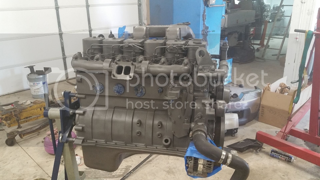

On the push rod side of the motor in the one pic, you replaced the factory cover plate with an aluminum cover with the 2 AN fittings near the rear. What's the AN fittings for and is the plate home made or bought? I've been thinking about upgrading mine on my 4bt and machining my own, and putting a vent on one of the valve covers.
not enoughsmoke
Aug 9, 2011
446
lynnville tn
Its a bought plate it just replaces the factory side cover for crankcase ventilation. My truck has a external breather can that it runs to instead of oil leaking out of a blowby tube on the ground. I prefer the cleaner look and its has no gasket just sealer some are o-ringed.

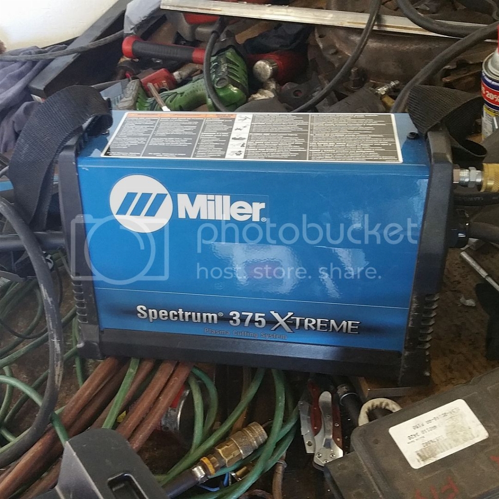

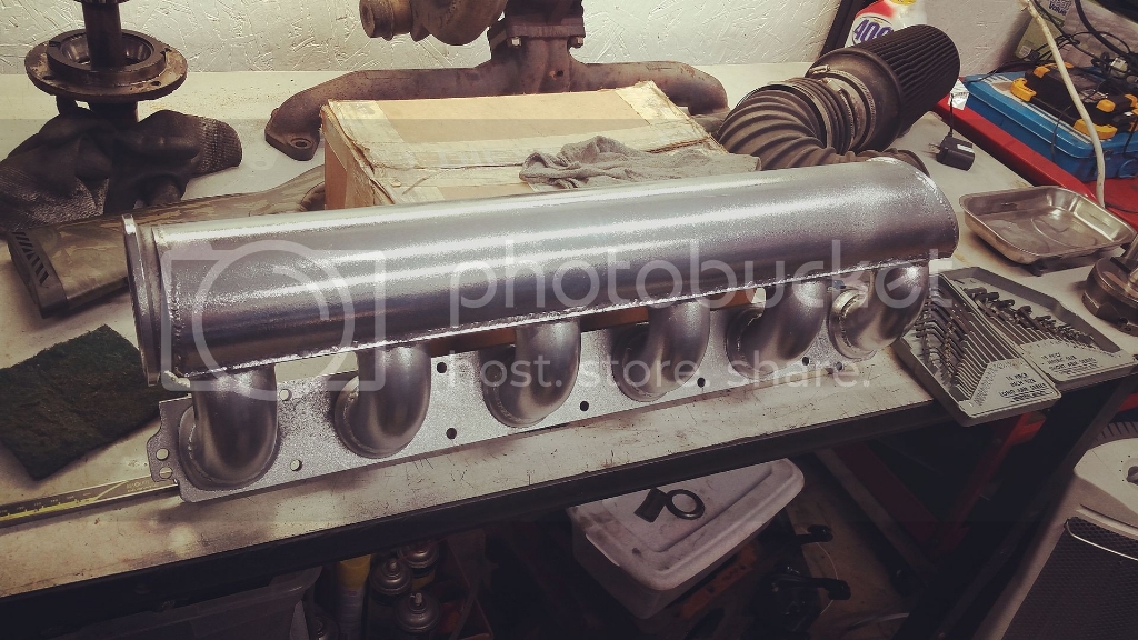

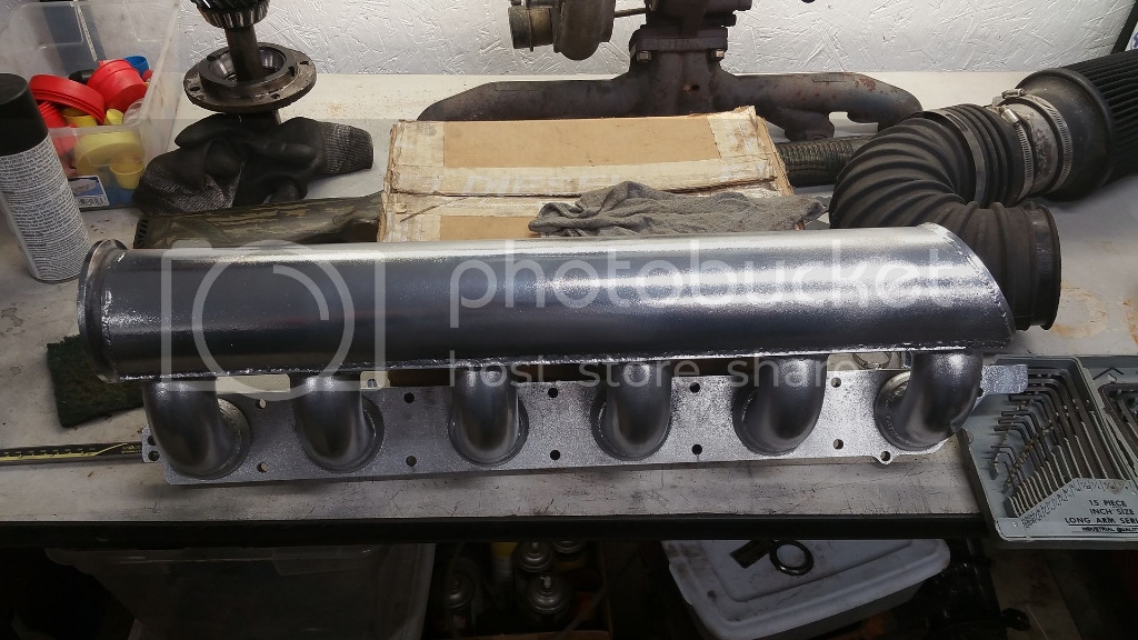

Its been a while since i updated i am still slowly getting parts together and coated. I also finally go the piece of the puzzle i been needing to help finish up the fummins fab work new 375 Xtreme plasma cutter. Not to mention trying to play dad and having another child I present to you Shelby my daughter and my sons play box.
