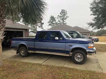

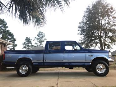

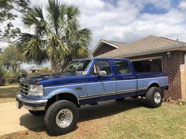

Attached is a photo of it when I brought her home, followed by the removal of steps, and a quick wax!

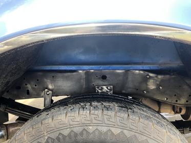

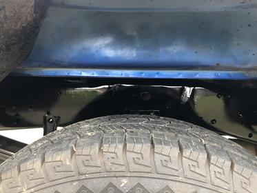

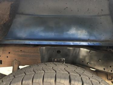

Since the last post, the truck has received the 3in mini leaf pack “leveling kit” that includes the drop brackets for the TTB and been aligned, requiring a 2° alignment bushing since a 1° was already installed and couldn’t get the alignment zeroed in.
Also, I started to clean up the welds that will be going on until I can get the axles under the truck.
I started to destroy the surface rust on the frame with a grinder and wire wheel, followed by a simple green bath, and hand towel dry :)
Then I used Krylon Pro Satin black, referred to by a paint and body friend of mine, and applied 2 coats. So far, so good!
On another positive note, Diamond Eye sponsored the truck build with a full exhaust!
On a not so positive note, I endo’d my YZ 450 at the track Sunday, and fractured 3 vertebrae..

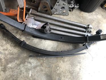

Well, been awhile since I’ve updated the post.
As for the fuel system, you just have to email Mrk, he donest have a “site so to say. But he does have a Facebook, Gazzotto’s garage.
Welds are on,
Truck just got a full paint correction,
Ordered 10” rear leafs from fab tech,
PMF long arm kit with new radius arm mounts.
RYD coil over mounts, Trac bar, and brake lines.

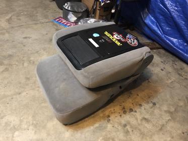

Also, had a buddy build me a box for the console, and it’s beautiful.
