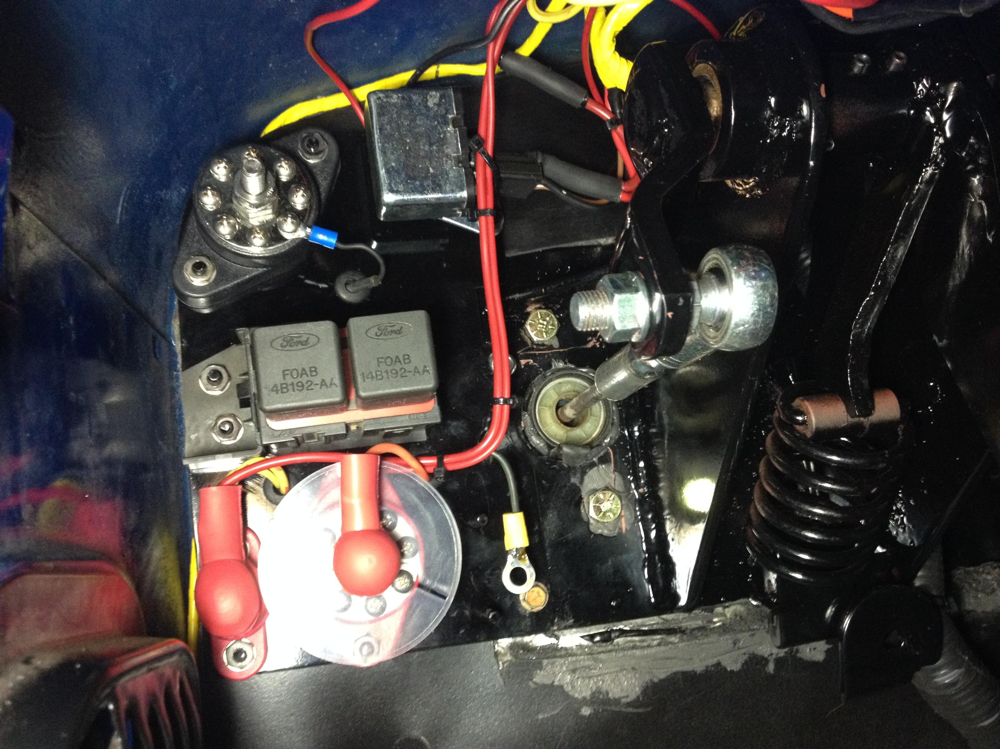

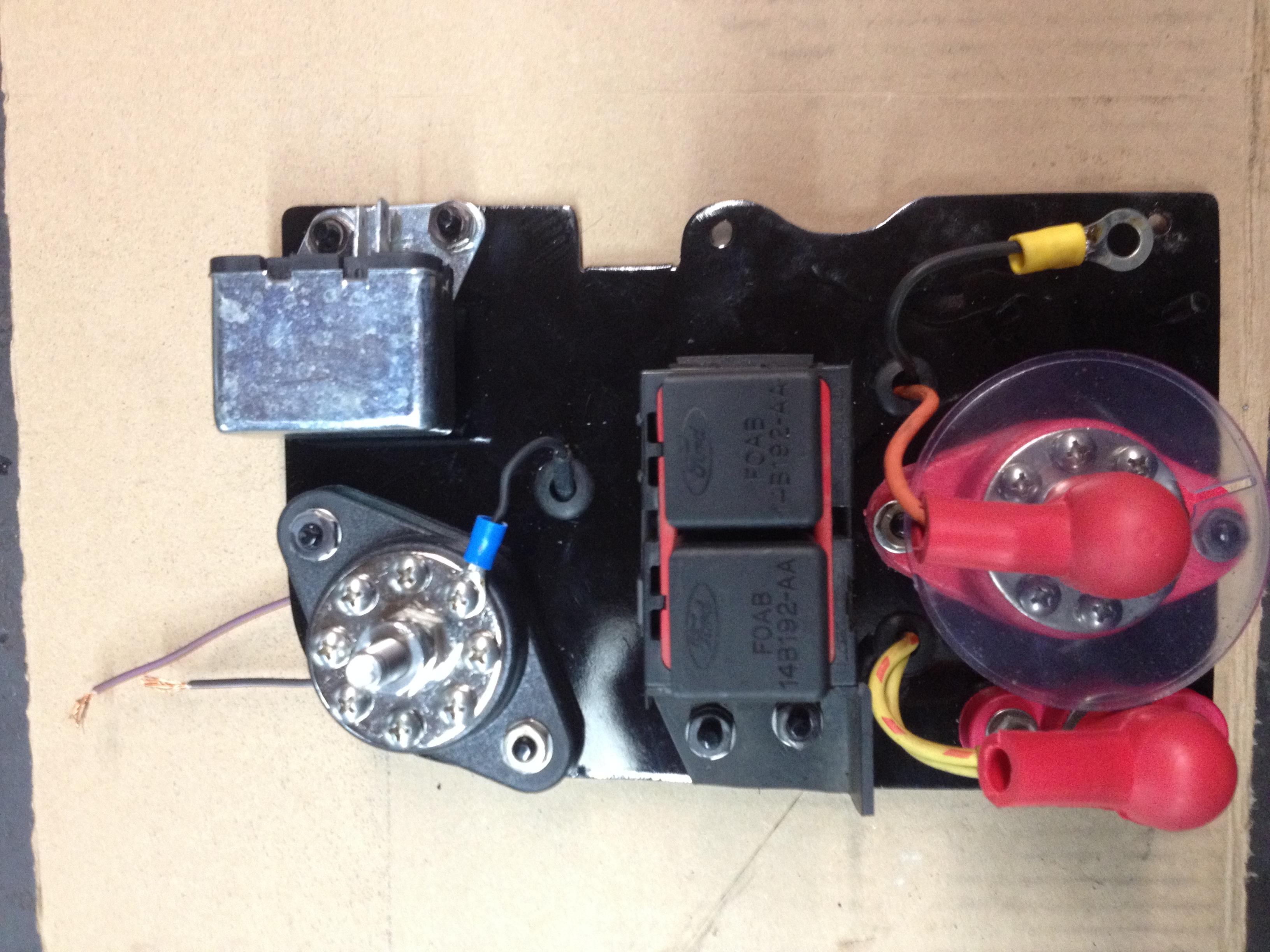

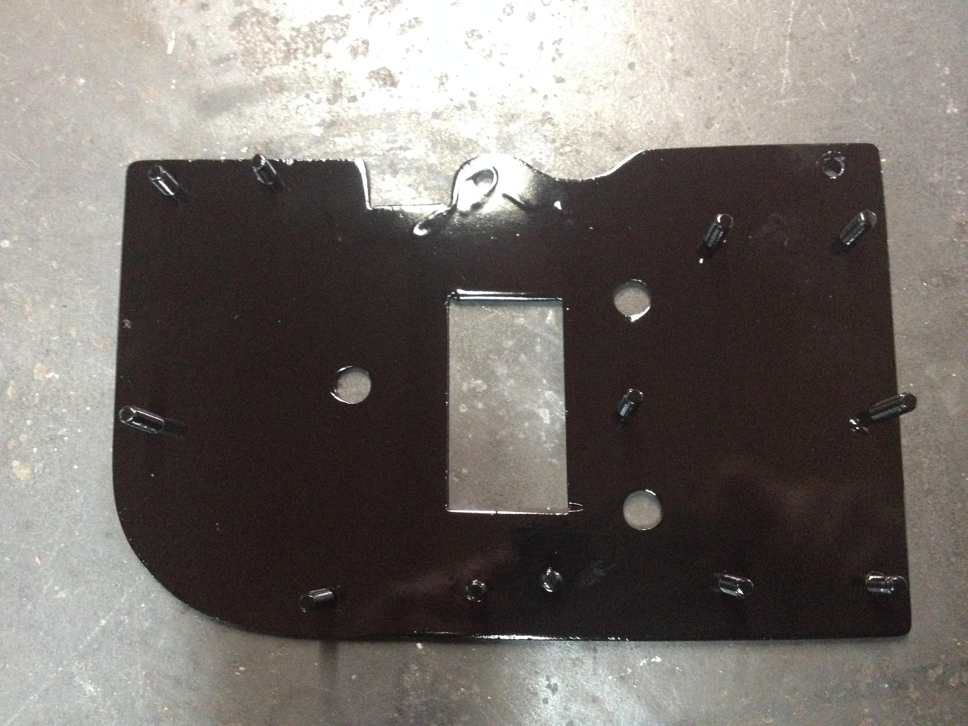

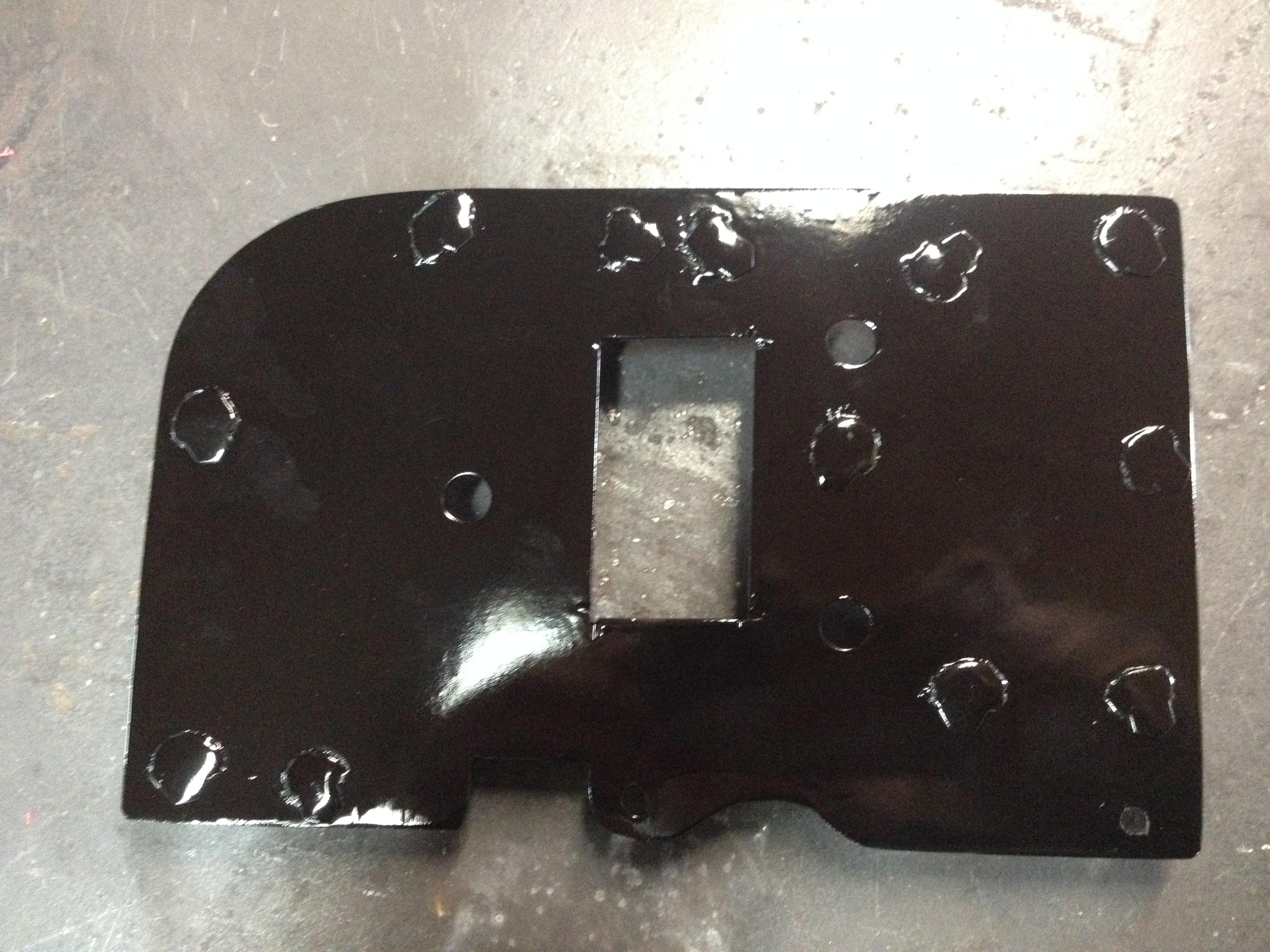

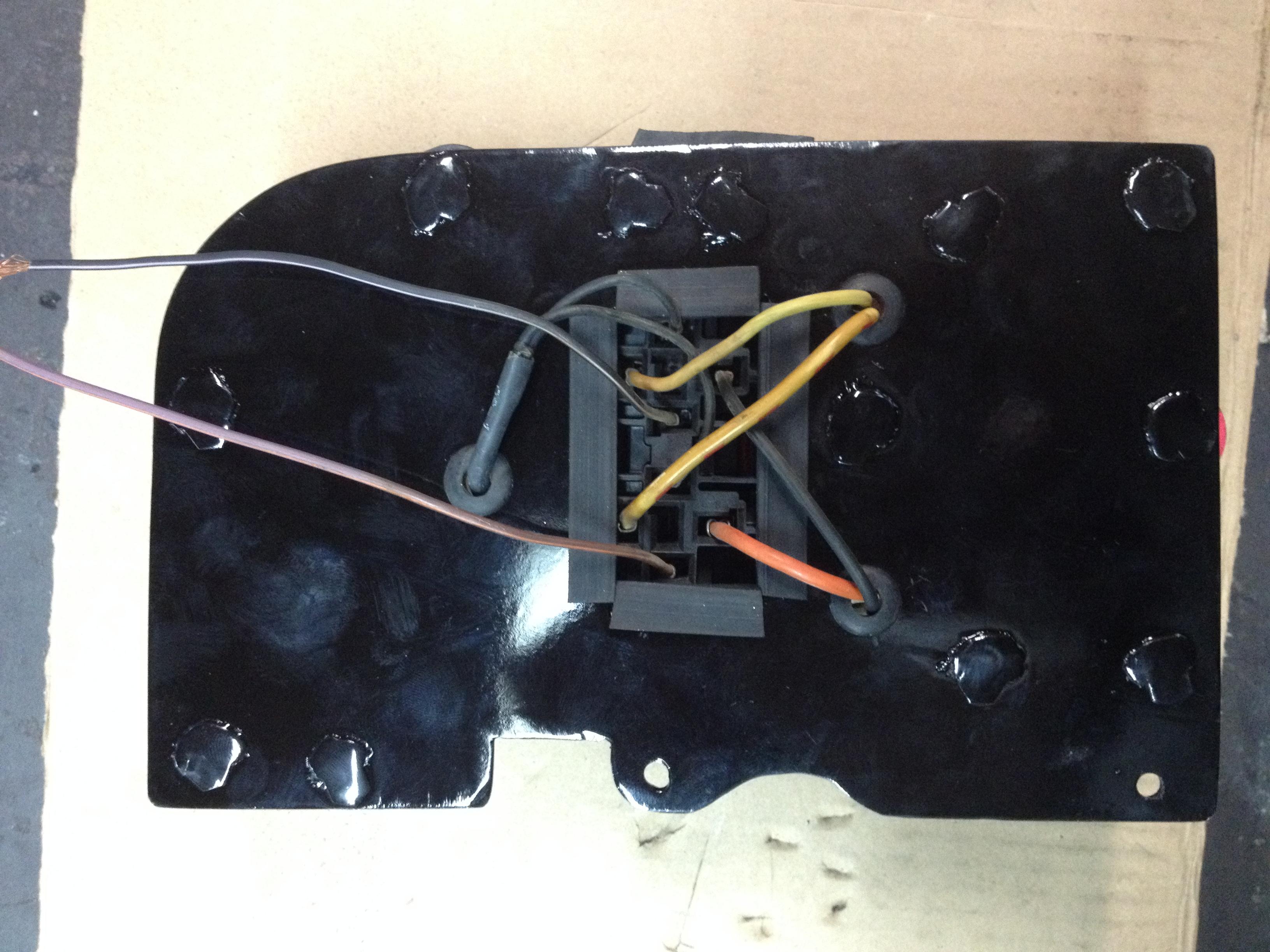

Here's a couple pictures of the "power distribution" panel I came up with. Top left is a ground terminal block, top right is the horn relay, middle section is a pair of relays I salvaged from the donor truck, they were the trailer tow package relays. One relay is for switched +12v and connects to the large red terminal block at the bottom. The other relay is switched by the headlight switch and connects to the small red terminal lug on the lower right (missing in the picture). I'll attach auxiliary lights to that lug (cab roof lights, trailer lights, gauge lights, etc). The single stud red block on the lower left is the battery lug (live +12v always). This setup will make adding and removing stuff easy now and in the future.

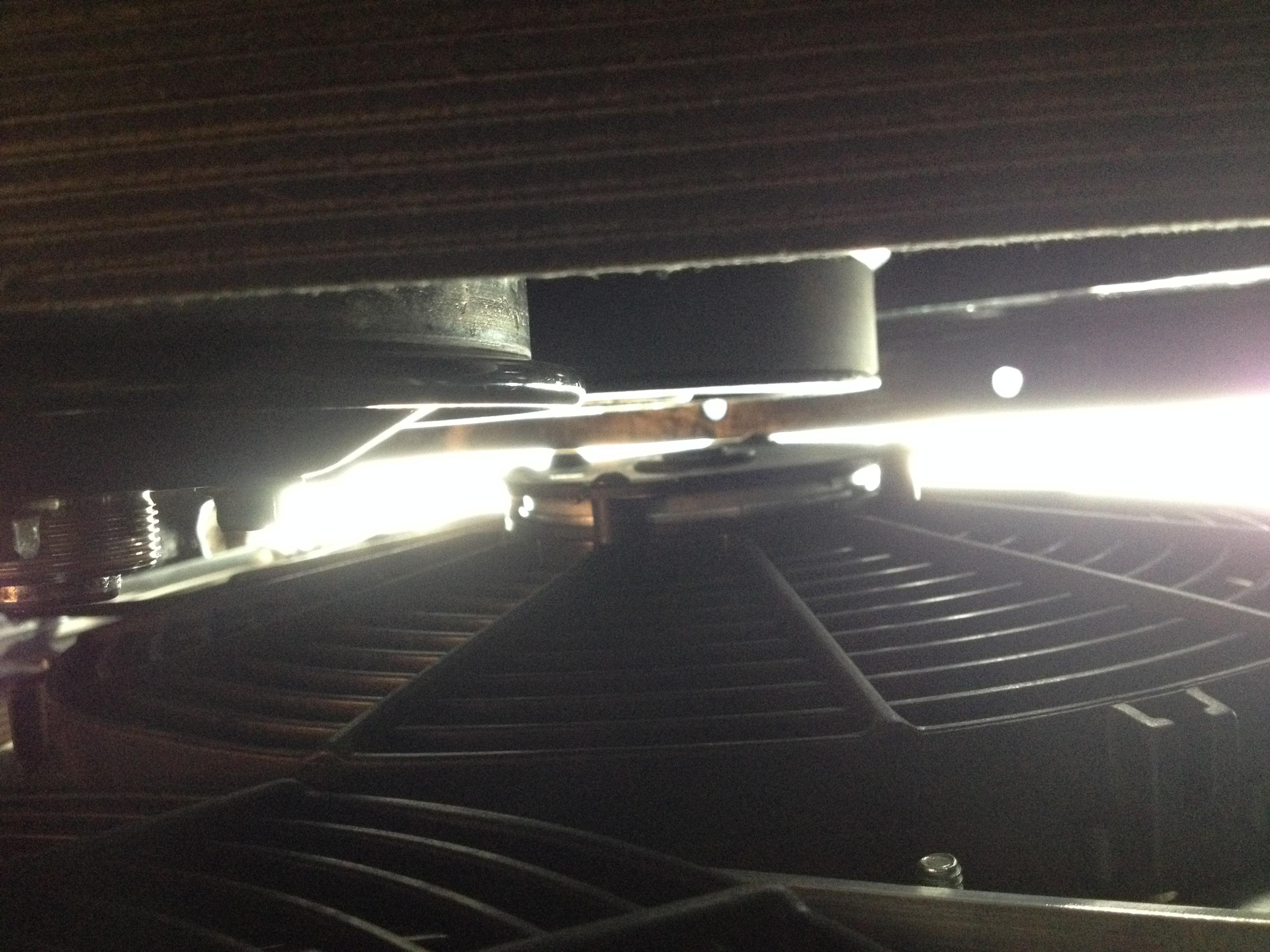

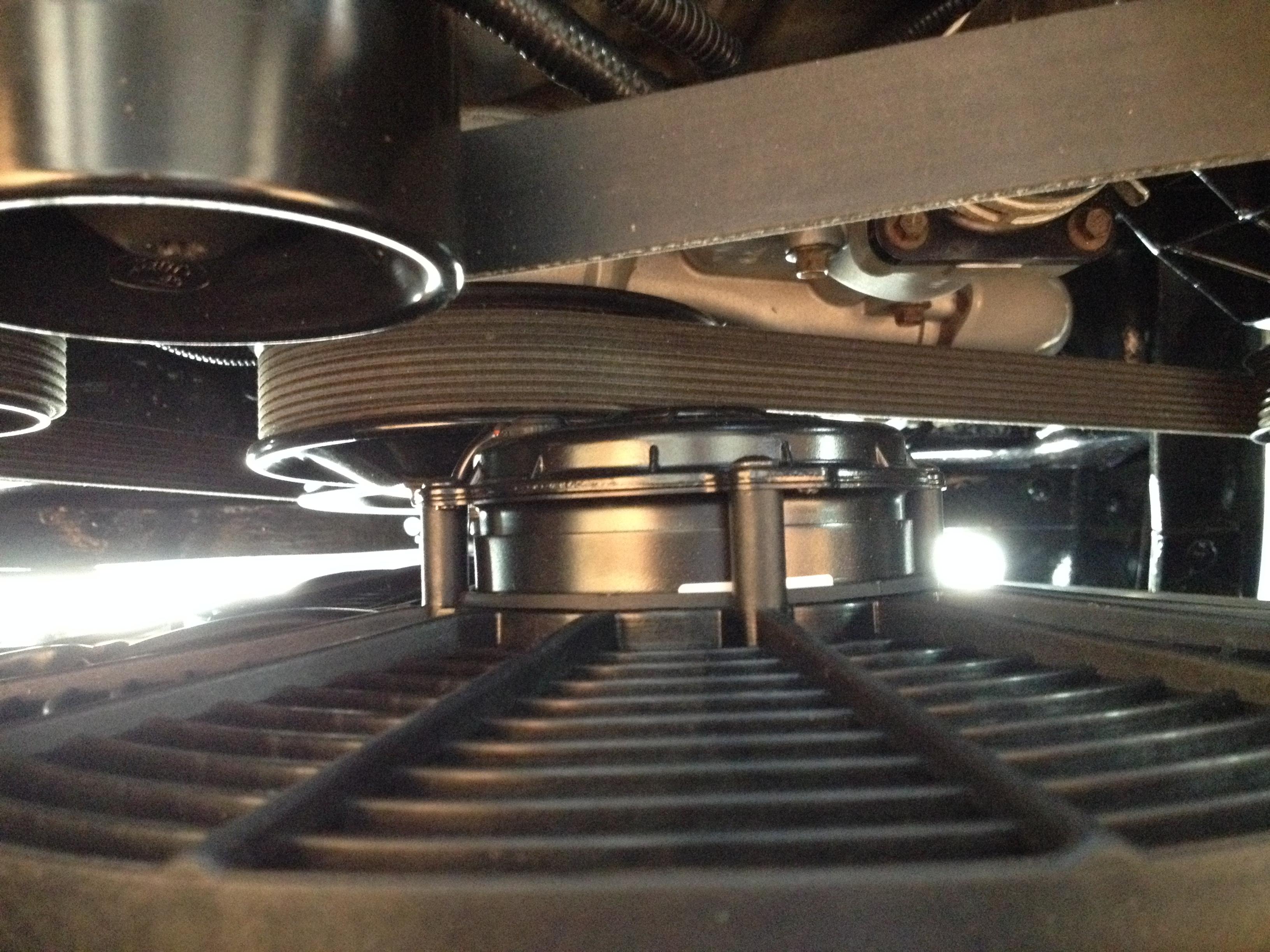

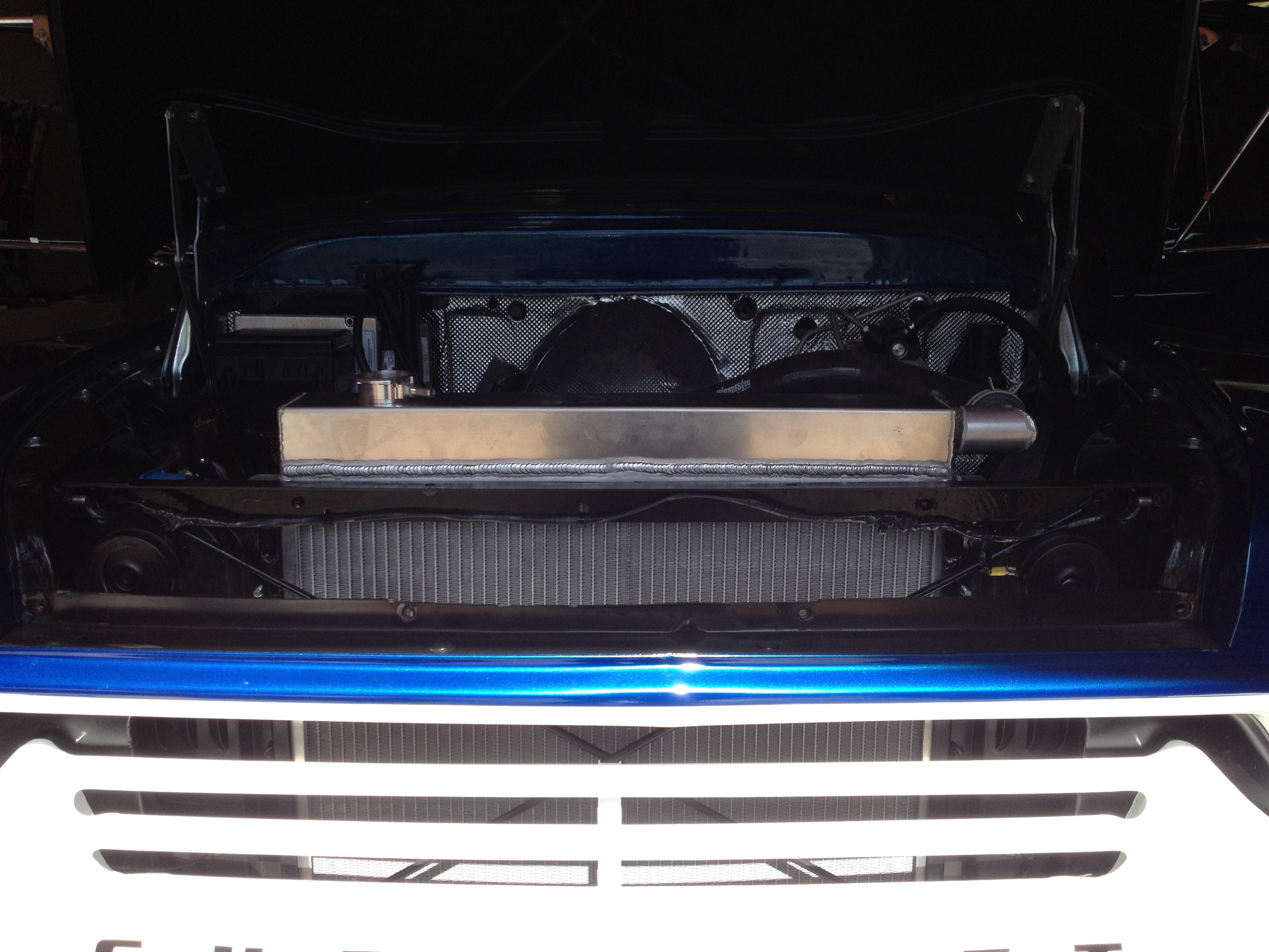

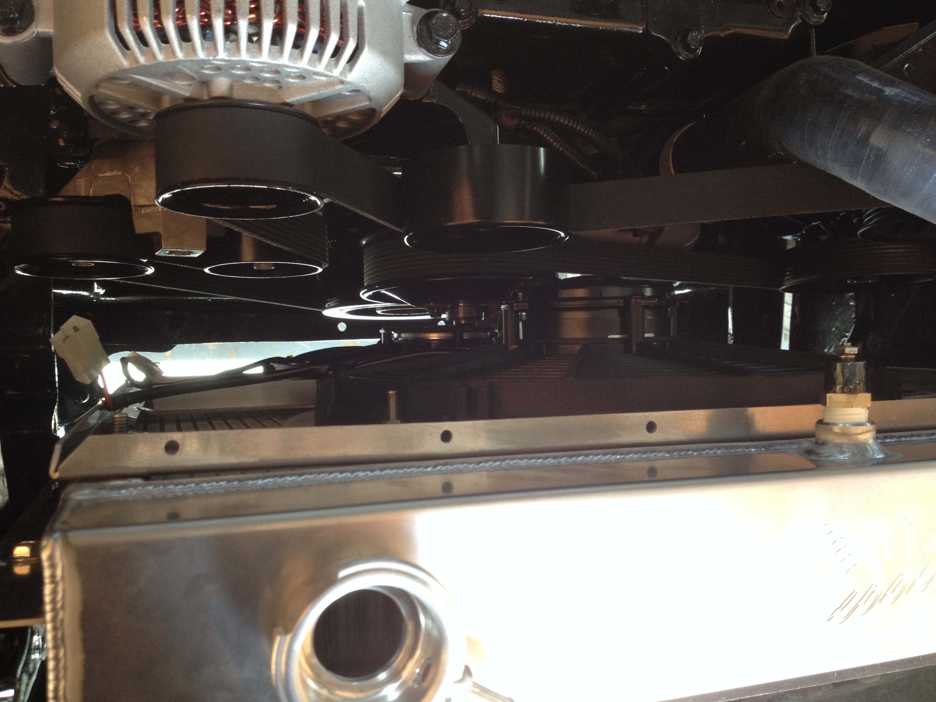

Set the radiator this weekend and everything looks good. I have about a half inch of clearance between the harmonic balancer and the fan motor. The bottom fan is a Spal 13” medium duty and the top fan is a Spal 13” heavy duty. The placement of the motor for the top fan worked out nice by fitting just inside the serpentine belt system where there’s large open space between pulleys. I forgot to snap pics of the upper and lower hoses, but they fit great too. The top hose is the original from the donor truck and the lower hose is the original from the donor with a small modification.

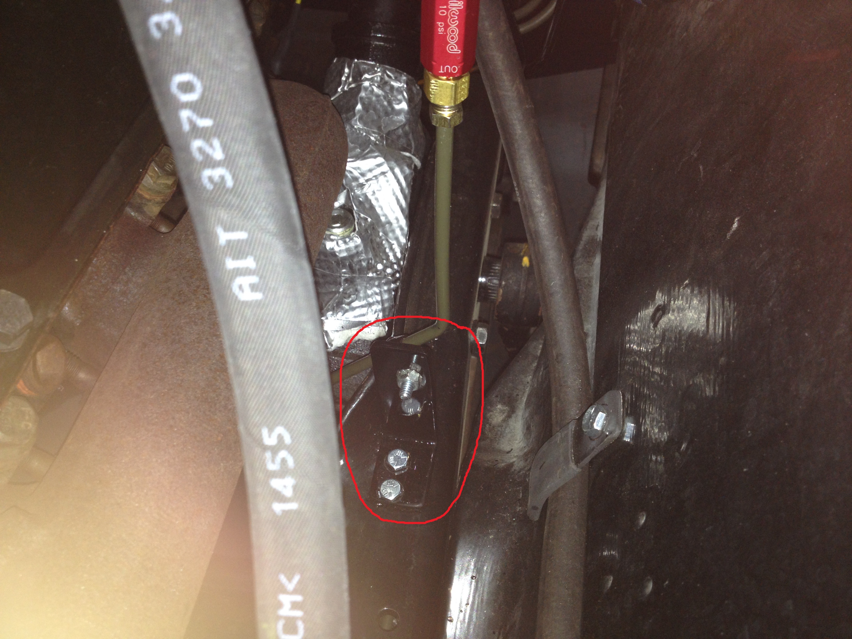

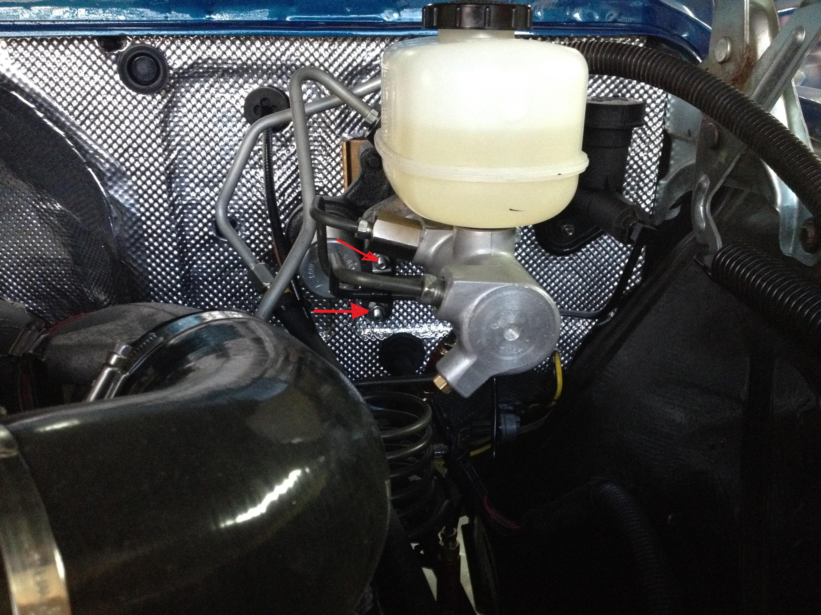

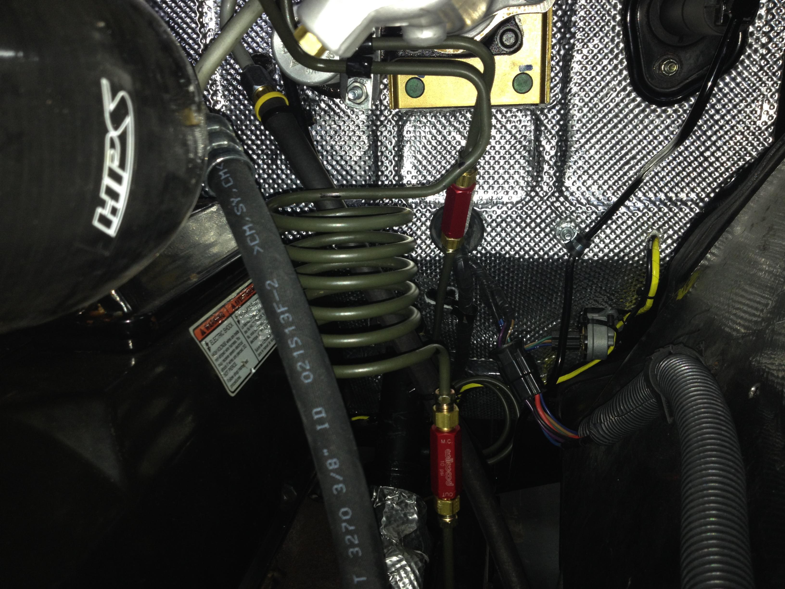

The brakes are now operational! The pedal isn’t as high as I wanted it to be but the feel and function is perfect. On a test run down the road I was able to easily lock up the rear tires. The 10 pound valves work great, the pedal response is consistent each time the brakes are applied. Overall the brakes are smooth, not sudden/jerky or slow in response; I’m very pleased with the outcome.
Also: the power and acceleration is INSANE! It’s a completely different truck and a total adrenaline rush. The amazing part is, I don’t have the Swamps IDM or the TS chip installed yet…. Holy smokes, not sure I can handle it!
Here are a couple personal notes to anyone who’s doing all new brake lines into a truck (these are seen in the pictures marked with red arrows or circled). These tips (I consider them requirements) will eliminate pre-mature failure of the brake lines at the fittings. I mention these only because I see alot of guys neglect these steps.
1. Tie the lines at the back of the master cylinder to some sort of bracket. This prevents the lines from moving at the fittings when the body and frame flex in different angles from each other.
2. Make a small coil of brake line shortly after the master cylinder. This acts like a spring to absorb the flex of the body and frame. The coils need to be on both front and rear lines.
3. Make a bracket to hold the lines to the frame, close to the fitting. Again, this prevents the line from flexing at the fitting.
