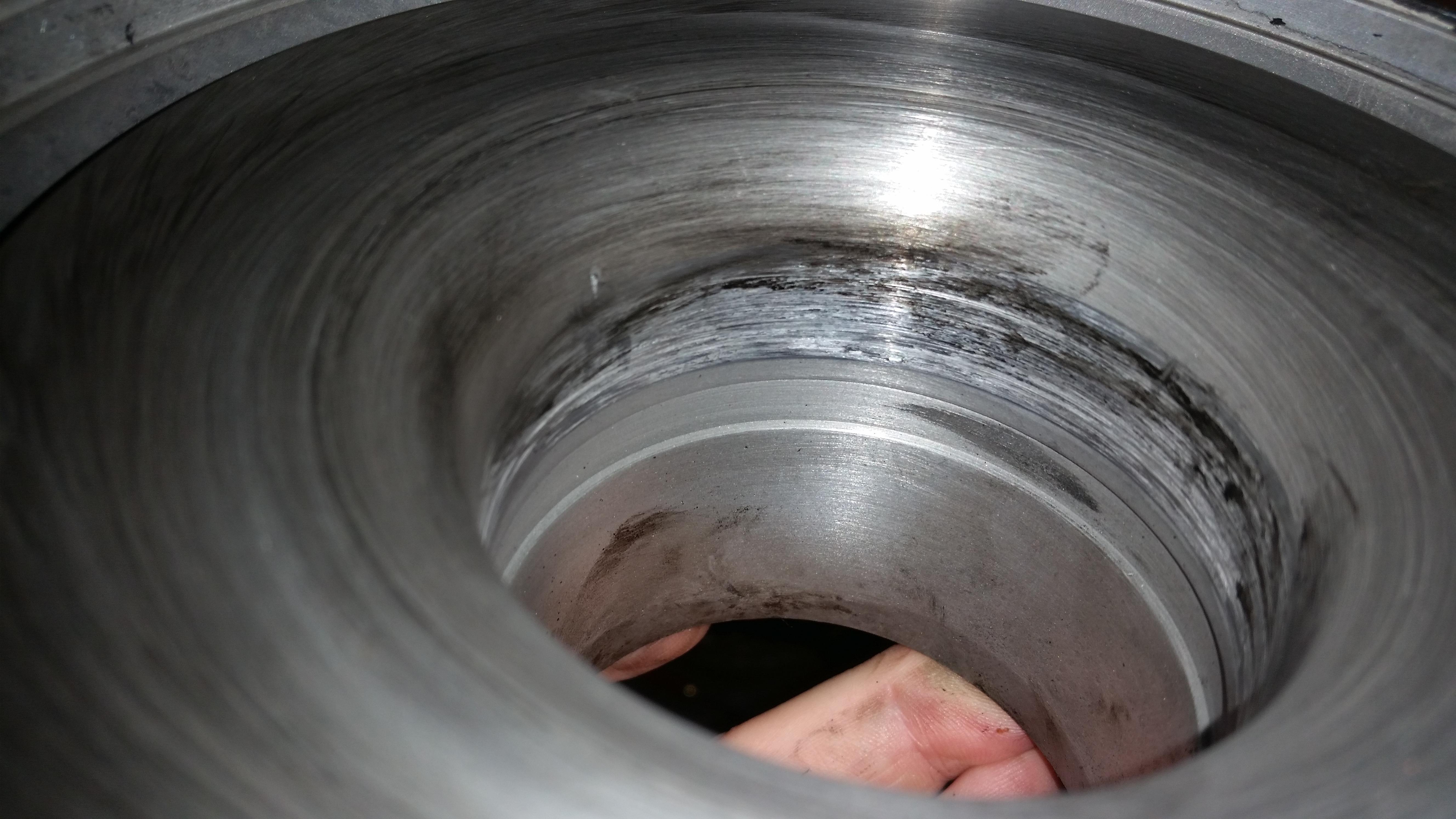

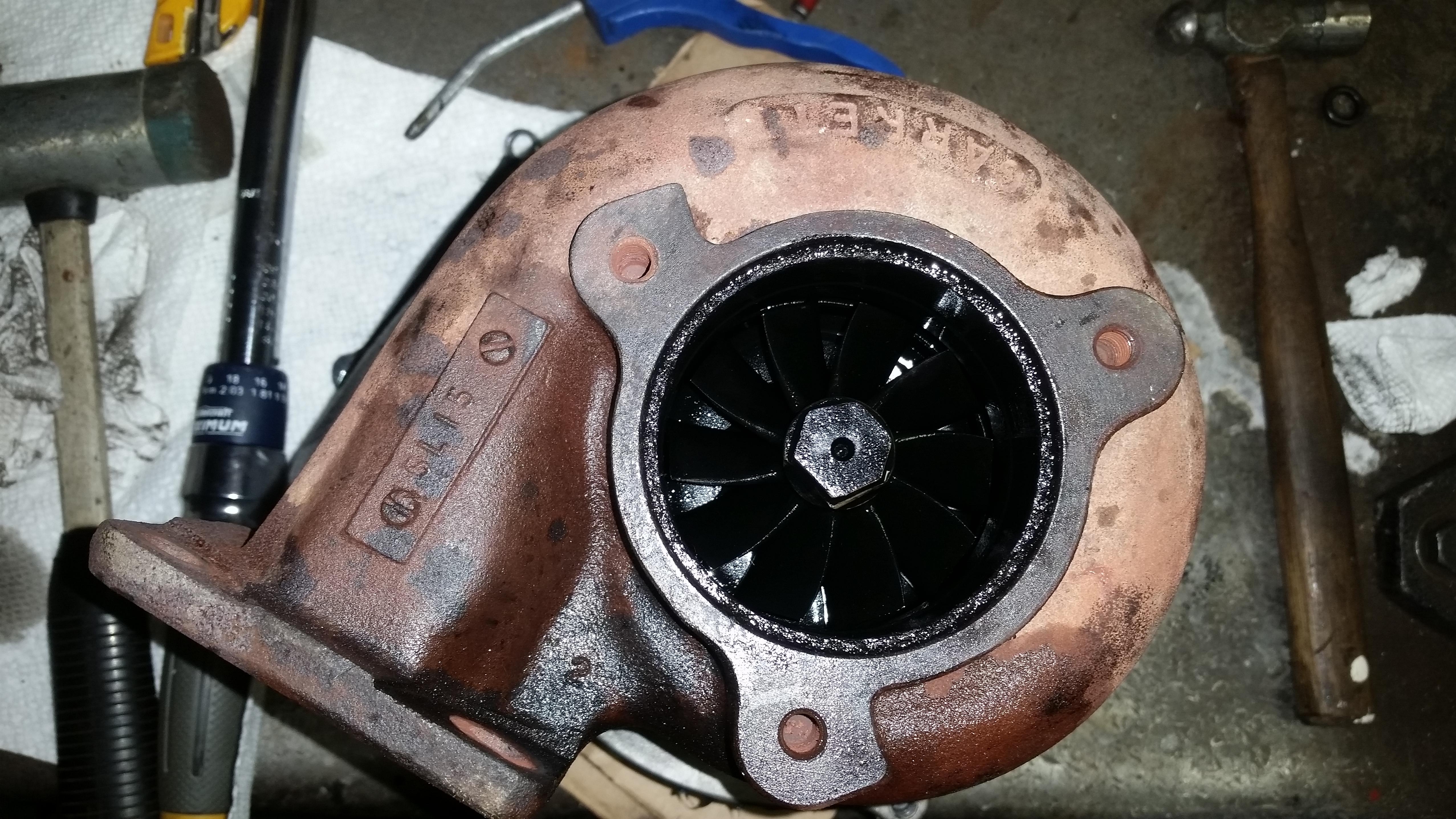

Here's my d66 I pulled out last week. I got efuel with 160/100s. It had a billet wheel and 360 thrust bearing. I did drive it hard repeatedly and hit 35-36lbs alot. It was laggy on the bottom end and smokey as a som o bich. Lasted just over a year, I hated it. Im glad it died, sad I wasted the cash tho. I put the stocker back on while I'm fabbing up a T4 mount. Way better response although it only hits about 28lbs I need it to last. So I'm not gonna push it. Do a search on "66" style turbos lotsa ppl have the same laggy and smokey stories. I just wonder if the 468 is ok to run with 160/100s till I upgrade to 300/200s. Or if I should get a 366 till i upgrade.
