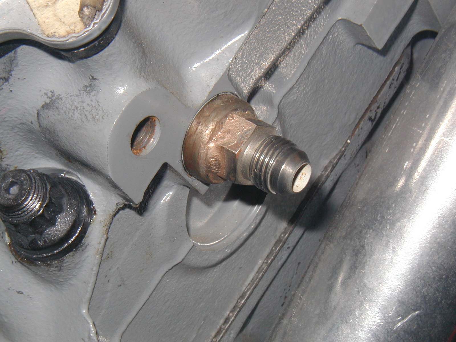

Actually, if you were to order these things from a catalog, they are called banjo bolts with or without the banjo. Even McMaster-Carr calls them banjo bolts. mj, you are correct. :naughty:
Here's one my buddy made for me modified for AN-6 fitting to the fuel rail gallery for fuel delivery. Its centerbored 25/64" (1/64 over 3/8"), two of the four side holes are bored and all burrs removed.
