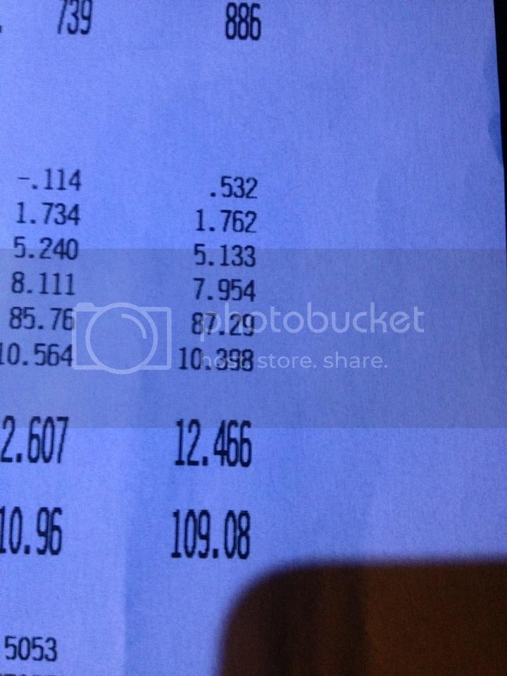

At the end of the season last year, the truck went 12.46 @ 109 on fuel in the thin air. I was super happy with that. At 8300lbs, the calculator says it's making north of 700.

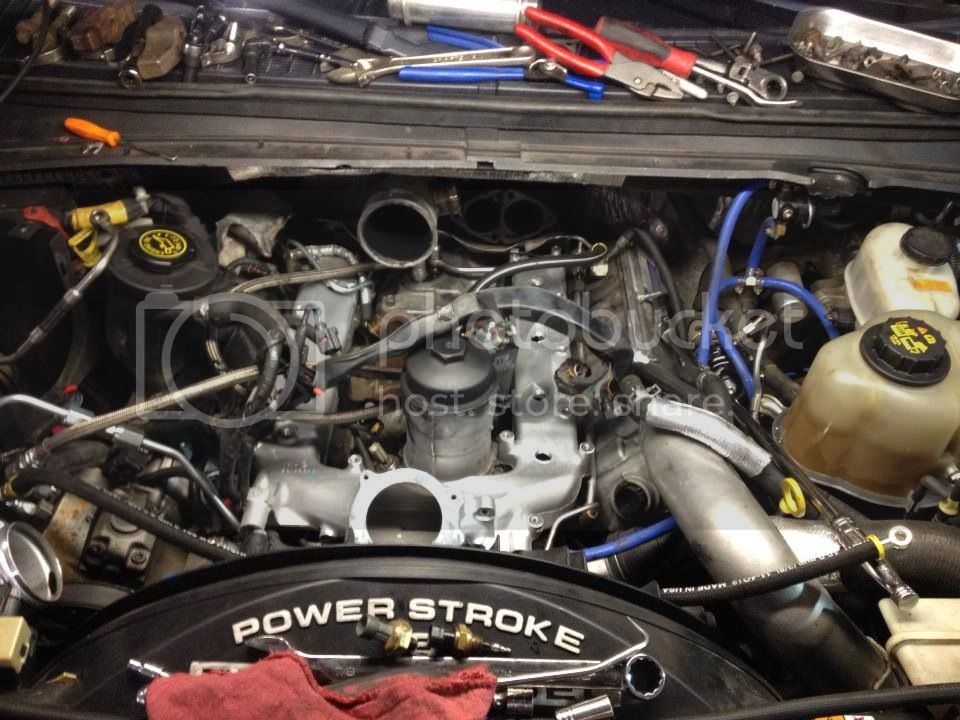

Nathannial and I put a Zmax Jr. ported intake manifold in the truck a while ago. It made a much bigger difference than I imagined. EGT's dropped a bunch, throttle response went up and smoke was down. I still need to look through the data logs and dyno sheets before I go into any of those details though.

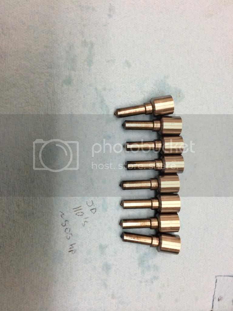

I also stepped up to some 110hp nozzles (50%). So far from the jump up from 60s, I am super pleased. Once the weather sucks less here, I'll get it back on the dyno to see where it stands in comparison to before.
