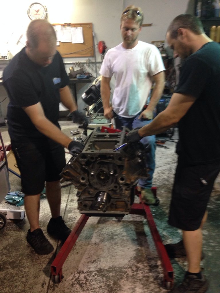

yes the rotating assembly was balanced. i wouldnt be a part of something like this if it wasnt done correctly. with the carrillos, .020" over pistons, gapless rings, etc the rotating assembly was way off.
The rotating assembly was 100 grams off when they started lol now it's within 2 grams! Pretty happy with that.
