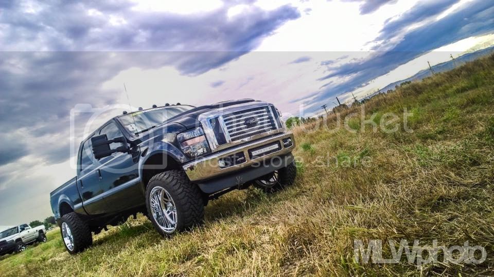

Anyway, I haven't been on here in too long, but unfortunately I haven't been able to do much with the truck this summer since I've been traveling and swamped with work lately! I was trying to go to world finals this year, but I never made a pass with NHRDA earlier this year, so that didn't pan out.
Anyway, the truck is doing great! Still improving on tuning slowly but surely and it's a blast on the street! It hasn't had an issue since DPC. Tows great, and drives awesome! Super happy with it. Hoping to improve fuel only performance a little in the coming months with some better flowing heads, but that's about all the plans I have for the motor. lol
