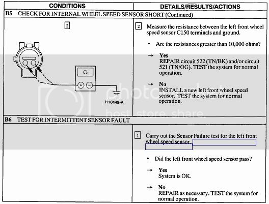

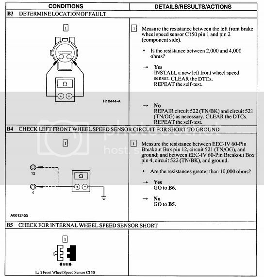

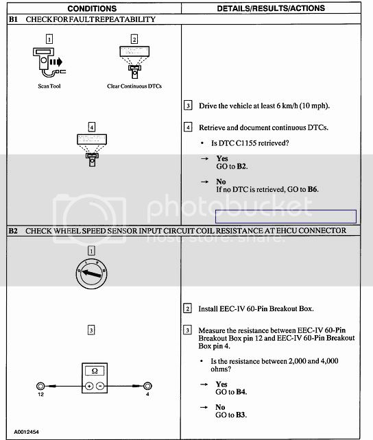

Hey guys so my ABS light came on about a week ago. The scanner said LF speed sensor input circuit fault. Friday my wheel bearing went out so I put a brand new Timken hub assembly with the ABS pigtail on it. The wheel bearing had chewed up the end of the old one so I thought that would be the light issue. Well the same code still comes up. I checked my plugs and everything. Tried clearing the codes but that didn't work.
Is the speed sensor and ABS sensor the same thing? Anyone have this happen to them?
