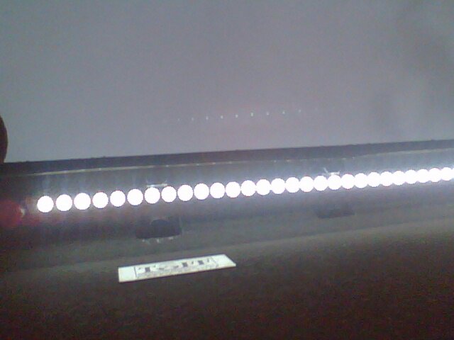

I've been heavily contemplating this, but haven't settled on a light source. Mainly because I was worried about the brightness and the dead zone in the middle of the bed. It appears the brightness of your lights is perfect. But misses the middle. Can you shoot a pic of the placement under the bed rails?
I was going to do what dsberman said with the angled wood but I got tired of looking at the LEDs sitting on the shelf so I threw them on there. I the dead spot in the middle doesn't really bother me because in the middle of the night I can see everything in the bed just fine.

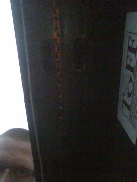

I've been and haven't posted on here in a while so I figured I would share.
I added some strips of LEDs to my tool box and underneath the bed rails...What a huge help they are at night. I have to wired to my cargo light so anytime the light comes on they turn on.
Ill post some pictures with out the lights turned on later.
Couldn't you mount the lights lower on the bed side to get more light in the center of the bed?
DcMoore
722
Amarillo, Tx
I have a rhino lined bed and I didn't want them exposed to everything in the bed moving around.
