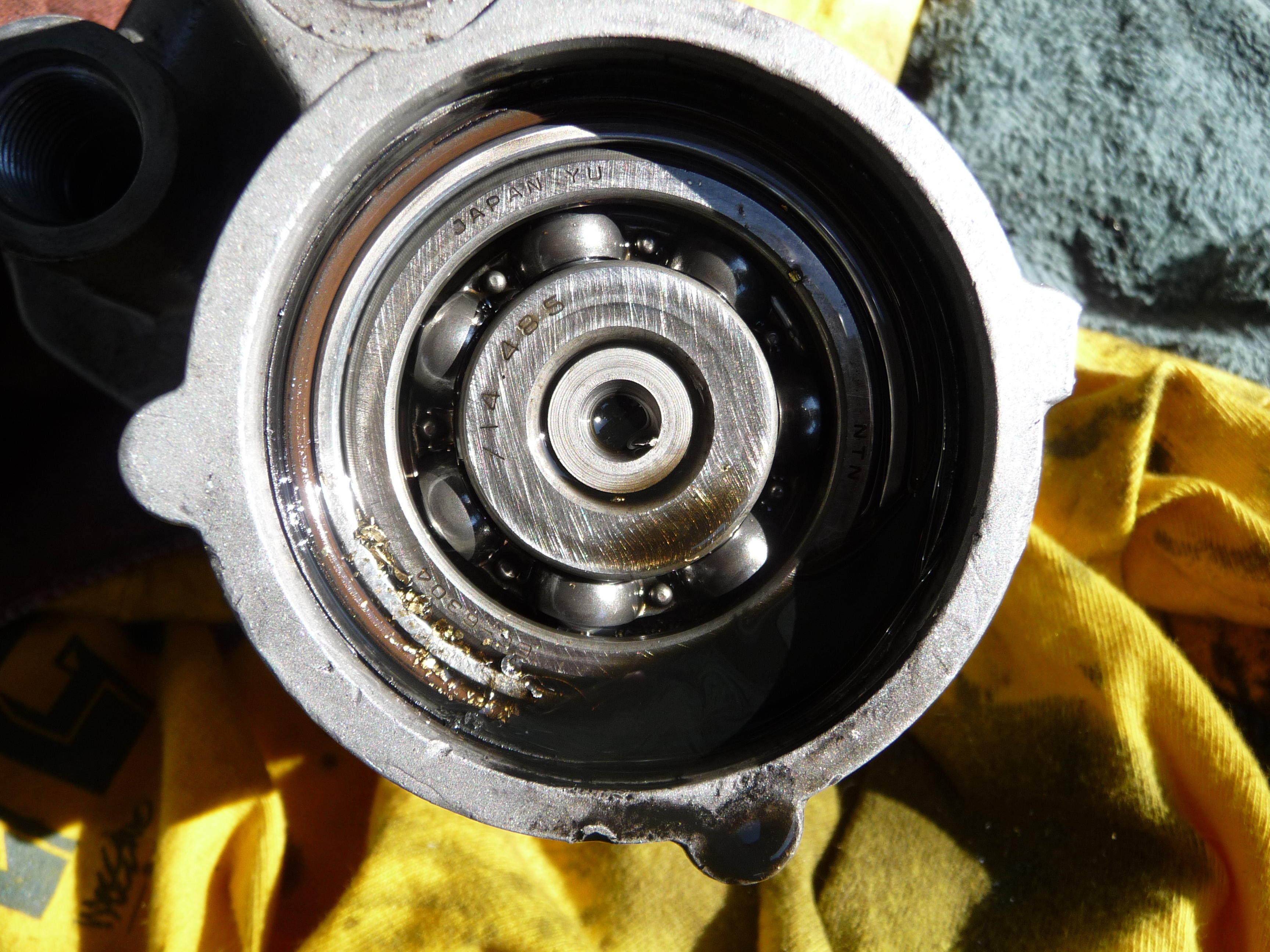

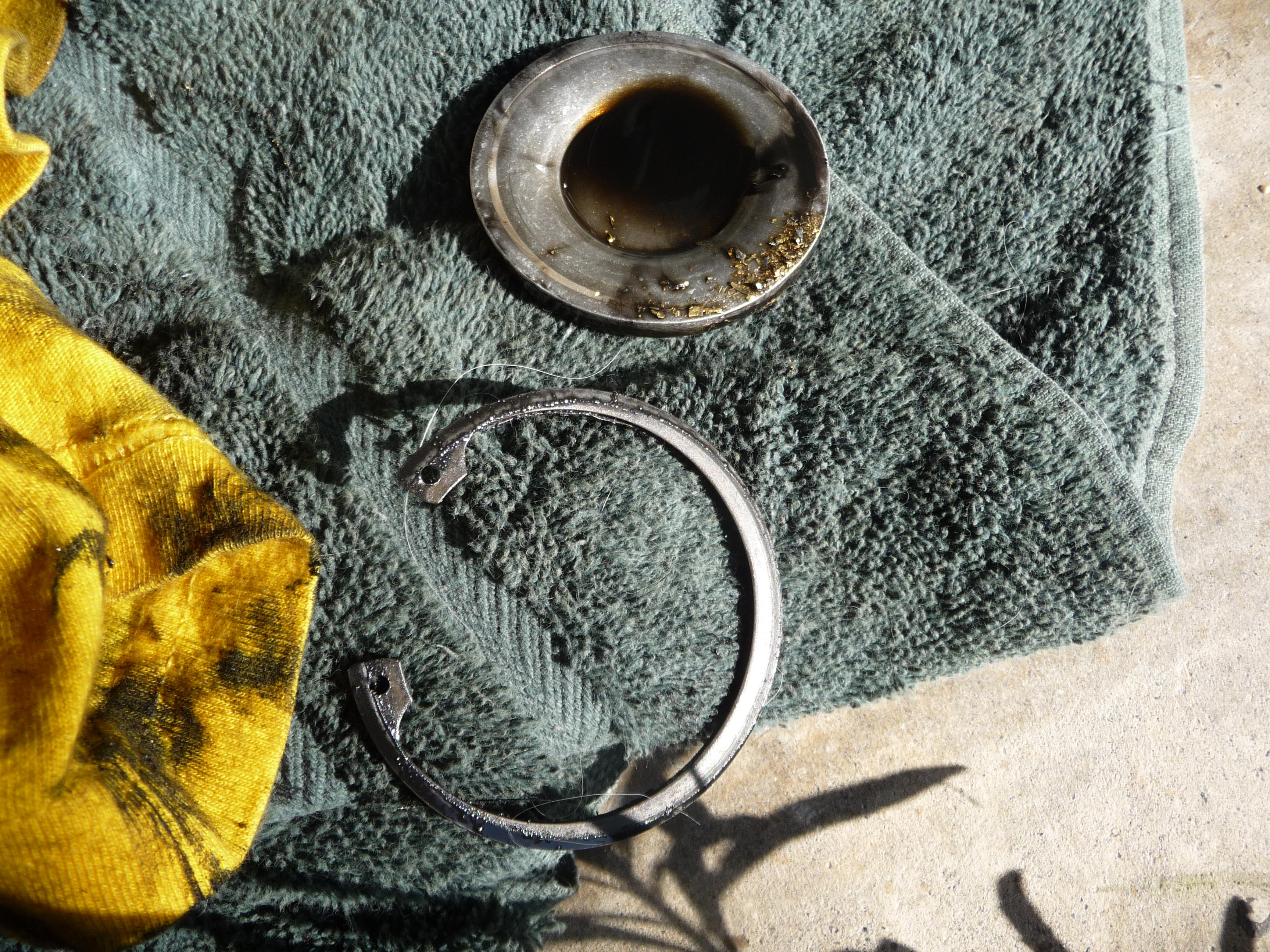

billymckay
Feb 26, 2012
Mine just died an ugly death.....I am not the original owner of the truck so I am not sure of the age. I do know I bought the truck in Oct of 2011 and have put 10k on the clock. I recall the original owner telling me the HPOP and injectors were 6 months old. So maybe 15 to 24 months old? Maybe 25K for milage?
No indications of any problems. Just cruising along on my way to work and instantly died. I though CPS at first, but that was a no go. Diagnosed that there was no HPOP pressure, and eliminated both banks as the cause.....so out it came.
Damn thing is crapping a ton of brass shavings out the front seal. It is seized up tight and will not turn.
I hope that the injectors survived.
