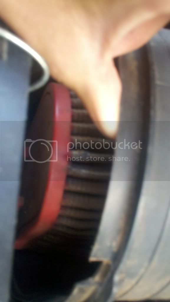

I'm just saying my AFE filter in stock box I feel is perfect. I don't have oil and dust residue from it and I know it breaths better. I clean it at every oil change and it takes me atleast 2 hours to do it well. Common knowledge stock intake is best? Yes, I feel that my set-up at least is pretty good for my needs. Protects from engine heat and heated air and with the zoodad mod it's a true CAI. For most people the stock filter works. Other people do need more air though. Saying the stock box provides air for 500 hp, it probably does, but i will still lay down more HP than with my AFE setup over a stock filter. If one is worried about dirty intake filters and such in the first place I feel that one isn't worried about maximum HP. Saying that If your filter gets that dirty from your daily driving then your just not ready for a clean perfect burning engine,

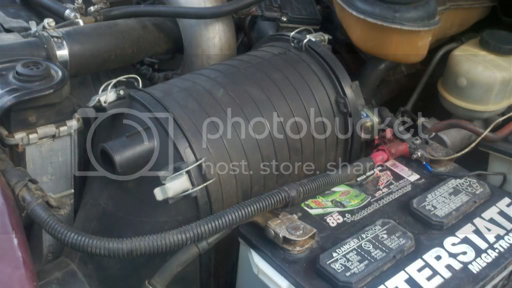

What is "Dougs intake air aid" exactly? And also.. do you have any pictures of your Zoodad mod and the AFE filter element?
None of zoodad yet looks like crap anyway lol

How does this filter mount in a 2005 f250sd?
Air Filters
Direct Fit
aFe Power MagnumFLOW OER PRO 5R Air Filters; Ford Diesel Trucks 03-07 V8-6.0L (td)
10-10100
look what I found
  • AFE FILTER.pdf
Mwilbur516
4,700
All you do is gut the original filter (take the paper element out of the black plastic case), insert the new element into the gutted plastic case and reassemble the intake into the truck.
