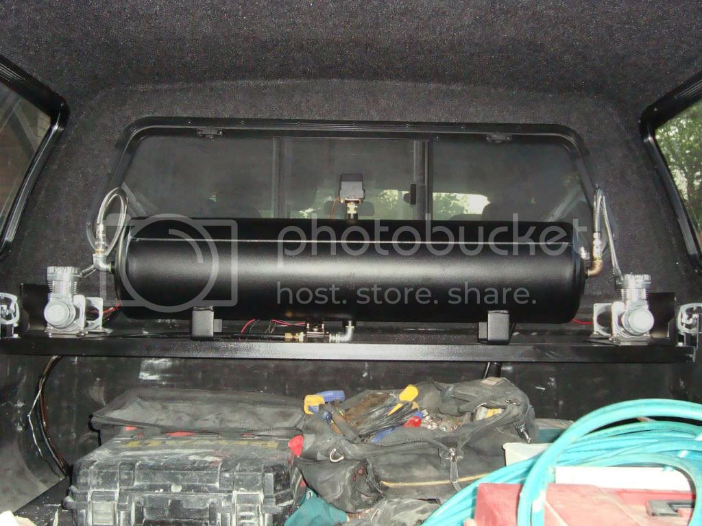

Heres another spot just to keep it out of cab ,you will hear it when it kicks on ,No air bags yet ,Im just running air acces ,and train horns ,I keept it mounted high enough i still could get lumber ,drywall ,etc.. under so i have full 8' bed , Still will have enough Air when it comes to installing my air bags

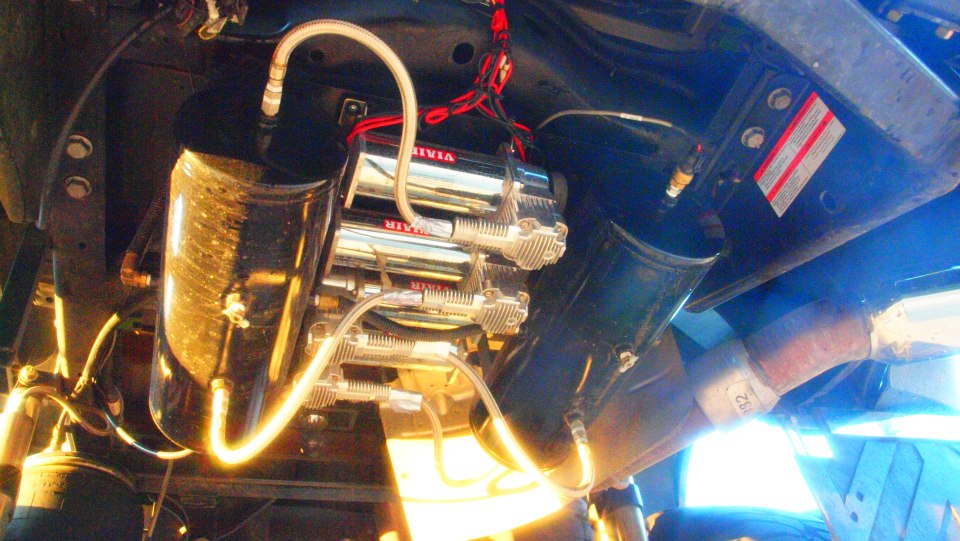

Passenger side frame rail. 90 degree drill. 4 holes. Solid as a rock.
Larger 1/2" line and valve. Way louder and more responsive for the horns. Also put a Air Chuck inline so I can fill up tires.
Probably not the best location for running to air bags but fits perfect.
What brand of air compressor are you running?

How do these mounts handle driving through the mud a lot? I would like to get something mounted underneath, but afraid the mud and water would screw them up
