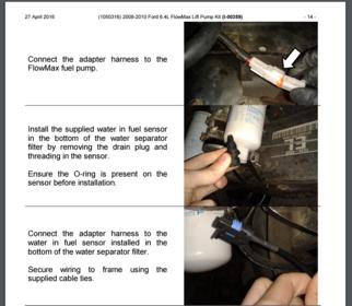

Thanks guys, did the install those push tabs were not cooperating lol, got er done soldered into the factory line, shrink wrap it up and it's running. Again thanks for the replays guys I appreciate it.
Lususs
May 19, 2016
3
And if anyone is curious I plan on picking up a donaldson p550550 water separator and installing the WIF sensor into the bottom of it (remove the petcock) and wiring the sensor back into the equation. I just looked over the instructions from the BD max flow lift pump for the 6.4 and this is what they do in their kit so I am going to see if it's possible to get the harness and sensor only from that kit and rig that up, it plugs into the factory location like we discussed here.
Only downside is having to remove the sensor to drain water but since I like the idea of still having the WIF sensor with the AD165 im gonna give it a go.
